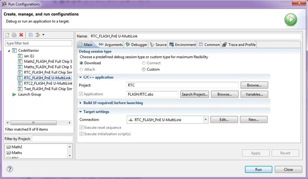

iansmusical
Contributor V
Hi Robin,
When I start a debug session I use F11 but I will try Control+F11 when I get home tonight and let you know if it made any difference.
Here are my run and debug configurations. I believe that target file is correct.
Ian
