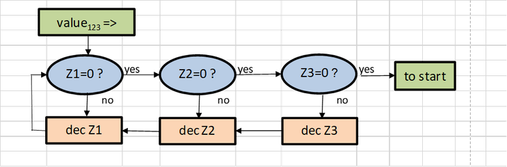

For high frequencies, i.e. short times, the controllers spoil us with timers.
But Software is necessary for very long periods of time. So, I developed a small counting loop with a few program lines with my S08 BDM board. A few RAM bytes are required as a counter. The simple algorithm is independent of the controller and programming language.
Algorithms for the 3-byte counter cycle       (Waiting loop for a single run)
  • Binary counter means that all bits of the bytes used are counted with increasing significance.
  • Counter for large numbers means: The maximum count number increases with 2n  of n bits. Three bytes of 8 bits each, can also count up to 224 = 16.777.216, Four Bytes can count to 4.294.967.296 and so on.
Time counters need a clock. For this I used a TPM channel xxxxx with a toggle output. This enabled me to measure the clock on port PTA0.

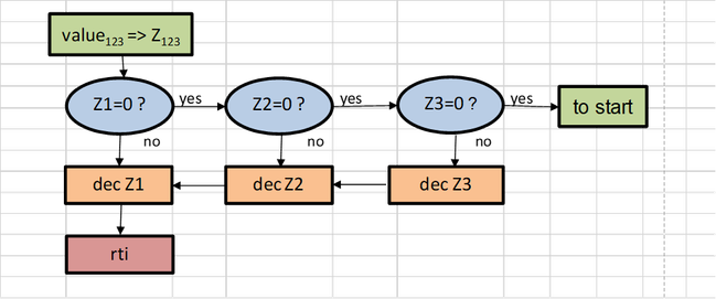

Here is the algorithm for the TPM-ISR controlled step-by-step operation of the counting loop:
Algorithms for step-by-step operation
The assembler program:

T_ISR:
bclr 7, TPMC0SC ; Clear overflow flag
bset 7, TPMCNTH ; setting of any bit clears the counter
; Counting the Interupts with 3 bytes,
tst Z1 ; see figure with the algorithm
E: beq Z
Ee: dec Z1
rti
Z: tst Z2
beq Ha
Zz: dec Z2
bra Ee
Ha: tst Z3
beq La
dec Z3
M01: bra Zz
La: bsr Load
; Switch PTB6
brset 6,2,L1
bset 6,2
rti
L1: bclr 6,2
rti
