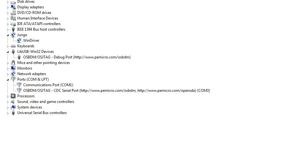

tom_thompson
Try the following:
1) Download the latest multlink drivers from P&E Microsystems at www.pemicro.com. Do not install it just yet.
2) With the board plugged in, Go to the Windows Device Manager and find the Jungo driver. Remove or disable it.
3) Unplug the board. Install the the P&E multilink driver software.
4) Plug in the board. You should have Windows say that it recognizes new hardware. When it wants to find the drivers, say no to Internet and yes to search your machine. This should install the proper driver from the P&E installation.
5) At this point, the hardware should be properly recognized. If not, unplug the board and plug it back in again. It should recognize the board and the yellow LED should light up.
---Tom

tom_thompson
The lack of a yellow light indicates a driver/communications failure. When you connect the computer to the board via USB cable, does Windows display a notice that it has recognized the USB hardware?
---Tom
