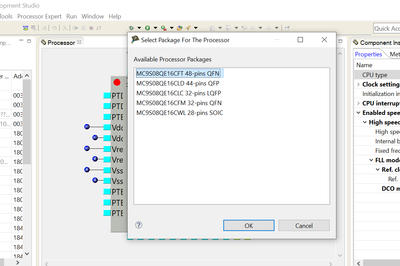

Hi!
Is there any way to program and debug an 8bit microcontroller (MC9S08QE16CWL, specifically) with CodeWarrior 11 or MCUXpresso?
I added the S08 Family to CodeWarrior 11, but it only has MC9S08QE16CFT.
Hope someone can help me.
Thanks in advance.

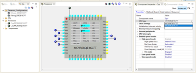

Thanks. I don't know why, but in my Codewarrior it only allows me to select MC9S08QE16CFT. 
Do you know how could I add the MC9S08QE16CWL to my workspace?
Thanks a lot

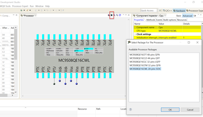

vicentegomez
Just click on the small component
regards

vicentegomez
the MC9S08QE16CWL is supported on cw 11
I hope this will help you
