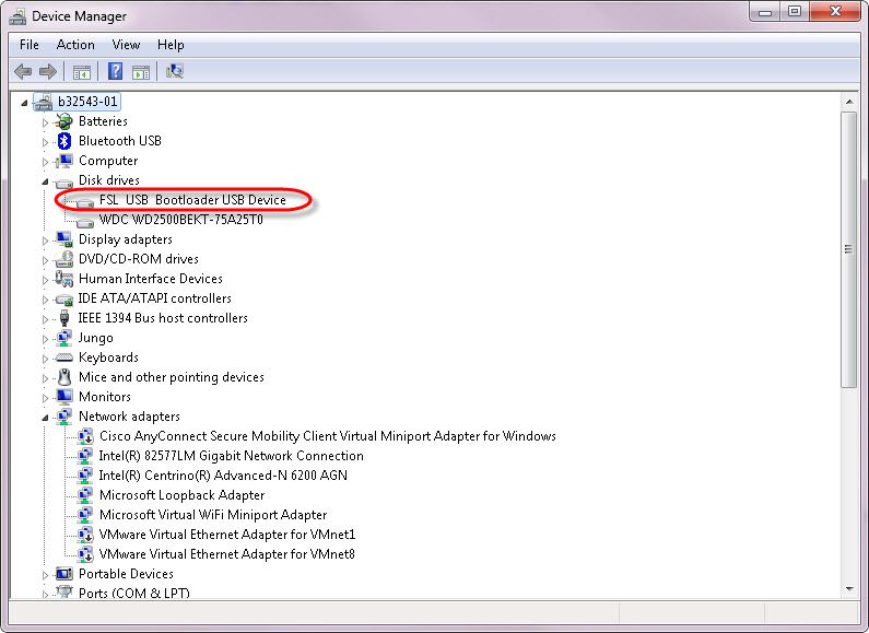

I am using MC9S08JM32/CodeWarrior for Microcontroller v6.3, and trying out the mass storage device (MSD) bootloader (AN3927).
I manage to run the bootloader program (re-flashing of the ROM code). But when the device re-enumerate itself, most of the time in the Windows XP Device Manager, the device is shown as a "USB Mass Storage Device" but with a yellow exclamation mark. I look at the Properties, it says "The Device cannot start", and the hardware ID is USB\VID_15A2&PID_003F&REV_0100
It does not fail all the time, sometimes after flashing, it re-enumerates itself as a FSL bootloader device, which is correct.
By why does it fail to re-enumerate most of the time?

When it fails, the data from USBlyzer looks like this:
Connection Status Device connected
Current Configuration 0
Speed Low (1.5 Mbit/s)
Device Address 0
Number Of Open Pipes 0
Device Descriptor
Offset Field Size Value Description
0 bLength 1 12h
1 bDescriptorType 1 01h Device
2 bcdUSB 2 0200h USB Spec 2.0
4 bDeviceClass 1 00h Class info in Ifc Descriptors
5 bDeviceSubClass 1 00h
6 bDeviceProtocol 1 00h
7 bMaxPacketSize0 1 10h Should be 8 bytes for low-speed devices
8 idVendor 2 15A2h Freescale Semiconductor, Inc.
10 idProduct 2 003Fh
12 bcdDevice 2 0100h 1.00
14 iManufacturer 1 01h
15 iProduct 1 02h
16 iSerialNumber 1 00h
17 bNumConfigurations 1 01h
4,928件の閲覧回数
