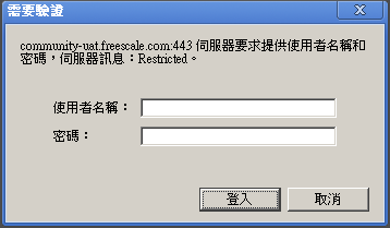

xiaolaba
Hello Pavel,
thanks for teply.
the JB8 device and used memory of existing project is about 1.5K, no big deal but a headache when remote upgrade is required.
anyway, there has problem but off topic to this thread but reading or linking to.
this forum has totally changed outline. when we try to see email notice & direct link to this thread, it is blocked by authentication. however, serach this thread via google, it is ok and login success. Anyone experienced this issue or just my login problem?
best regards,
xiaolaba

I don't know if this issue was my fault or there is a bug in the automatic redirection of vectors.
Thanks, regards
