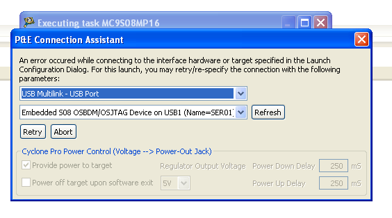

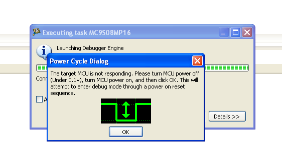

Yes, I have this board and i did everything you wrote. I even checked BDM signals with oscilloscope and everything seems to be fine. Reset button on both boards (on board TWR-MCF51CN and board of my BLDC) is working in both sides. I can't communicate with it in CodeWarrior 10.6. That;s what happen.     W
When I try to reconnect this shows.
Then it's just error when I click 'Abort'. I try to upload empty program with all libraries of MP16 board. Is there any other way to check the communication?
