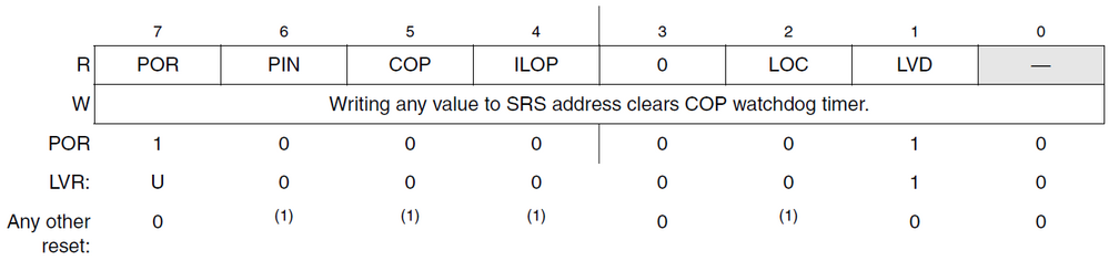

  • “Writing any value to SRS address clears the Watchdog timer”: It is included in devices like the S08AW60, S08JM60, and S08QE32. Figure 1 shows the register description of S08JM60 device:

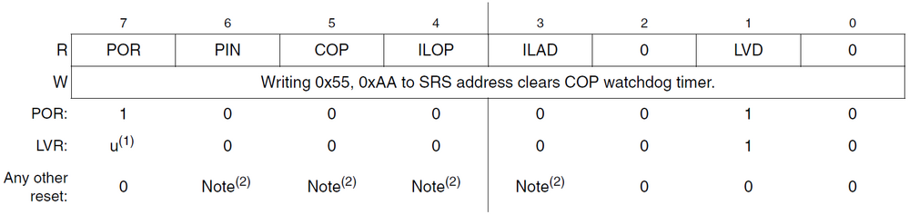

  • “Writing 0x55 -> 0xAA sequence to SRS address clears the Watchdog timer”: It is included in devices like the S08DZ128, S08MM128 and S08SG8. Figure 2 shows the register description of S08SG8 device:
Figure 2: SRS register on S08SG8 device.
Taking as reference the second case, it is possible to generate a Software Reset by writing a value different than 0x55 or 0xAA, to SRS register. It is based on the following sentence, included on the Watchdog description section of device’s Datasheet/Reference Manual:
“The COP counter is reset by writing 0x0055 and 0x00AA (in this order) to the address of SRS during the selected timeout period. Writes do not affect the data in the read-only SRS. As soon as the write sequence is done, the COP timeout period is restarted. If the program fails to do this during the time-out period, the MCU will reset. Also, if any value other than 0x0055 or 0x00AA is written to SRS, the MCU is immediately reset.”
However, there are some conditions that could cause that the reset is not such immediate. If the COP is cleared (writing 0x55 and then 0xAA) and the 1 KHz clock is being used as COP clock, there is a window of 1 or 2 clock cycles after the timer clear when the circuitry is resetting the counter.  If a write of bad data is done right after the timer clear within such 1-2 clock window (1-2 ms) the COP will not be reset until the next write (of any value).
