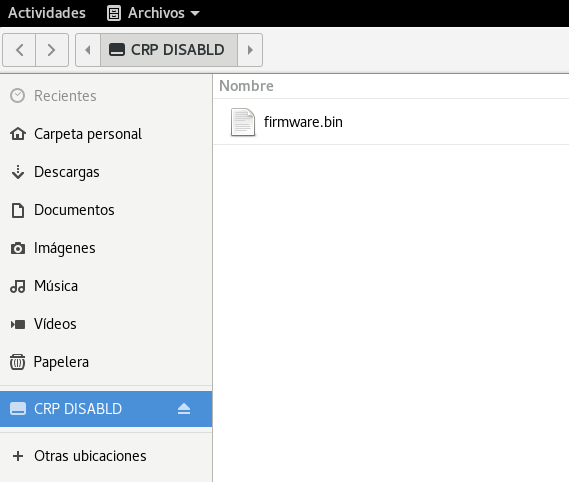

Hi everyone!
I have a LPCXpresso1769 rev D1 bought a year ago. It's new one.
When I connect it to my laptop it appears like a flash memory with name "CRP DISABLD":
Of course, the IDE can't connect to the stick because it can't see it.
I'm using in Linux Debian 9 (probed in several OS, but always with the same result), the dmesg shows:
[ 1304.007003] usb 1-2: new full-speed USB device number 12 using xhci_hcd
[ 1304.152671] usb 1-2: New USB device found, idVendor=1fc9, idProduct=000f
[ 1304.152679] usb 1-2: New USB device strings: Mfr=1, Product=2, SerialNumber=3
[ 1304.152685] usb 1-2: Product: LPC1XXX IFLASH
[ 1304.152689] usb 1-2: Manufacturer: NXP
[ 1304.152694] usb 1-2: SerialNumber: ISP
[ 1304.153675] usb-storage 1-2:1.0: USB Mass Storage device detected
[ 1304.153981] scsi host2: usb-storage 1-2:1.0
[ 1305.183996] scsi 2:0:0:0: Direct-Access     NXP      LPC1XXX IFLASH   1.0  PQ: 0 ANSI: 0 CCS
[ 1305.185583] sd 2:0:0:0: Attached scsi generic sg1 type 0
[ 1305.185799] sd 2:0:0:0: [sdb] 132 512-byte logical blocks: (67.6 kB/66.0 KiB)
[ 1305.186224] sd 2:0:0:0: [sdb] Write Protect is off
[ 1305.186239] sd 2:0:0:0: [sdb] Mode Sense: 03 00 00 00
[ 1305.186588] sd 2:0:0:0: [sdb] No Caching mode page found
[ 1305.186607] sd 2:0:0:0: [sdb] Assuming drive cache: write through
[ 1305.202041]  sdb:
[ 1305.204162] sd 2:0:0:0: [sdb] Attached SCSI removable disk
I'm using MCUxpresso 10.2, but it's probed in other IDEs and always it can't connect it.
Is there some procedure to resolve this?
Thank you so much!
Mariano

Try using a ISP Reset over debug, please check the below link:
Sol

Hi Sol, thank you so much for your help!
I tried some of the several methods from the link that you suggested without luck.
In some of those, I read that I have to enter to ISP mode, well, I pretty sure that I did because I used FlashMagic and I can flash the LPC with an image (a simple .hex) that works; I mean, the program do what they have to do.
Any help will be appreciate.
