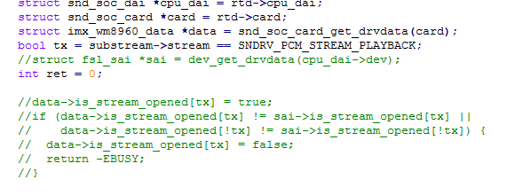

yes, i can tell you what modifies i have done with wm8960.c and  imx-wm8960.c   this two files.
14,429 Views
yoshiharuseirik
Hi Huang
Thank you for your reply.
 > are you a japaness?
Yes.
Thank you for providing the information.
My method modified only imx-wm8960.c and confirmed that it works with a combination of wm8960 and imx6(Quad)-SSI on my environment.
I used "aplay" and "arecord" to check the operation.
The rough change contents are as follows.
・base code is imx-wm 8962.c.
・description part of FLL is changed to PLL(WM8960_SYSCLK_AUTO).
・description part of "ADC - MONOMIX" commented out.
・character string used in the device tree is set to imx-wm8960.c
・"imx_wm896x_rates" is set to imx-wm 8960.c
・Initial setting of register is described in function imx_wm8960_late_probe()
best regards!

    amic-mono;
modifications to imx-wm8960.c  ( please note that my code is base original imx-wm8960.c  , NOT imx-wm8962.c )
static int imx_wm8960_probe(struct platform_device *pdev)
        struct device_node *np = pdev->dev.of_node;
    struct device_node *cpu_np, *codec_np = NULL;
    struct device_node *gpr_np ;
    struct platform_device *cpu_pdev;
    struct imx_priv *priv = &card_priv;
    struct i2c_client *codec_dev;
    struct imx_wm8960_data *data;
    struct platform_device *asrc_pdev = NULL;
    struct device_node *asrc_np;
    u32 width;
    int int_port, ext_port ;
    int ret;
    priv->pdev = pdev;
#if 1
    ret = of_property_read_u32(np, "mux-int-port", &int_port);
    if (ret) {
        dev_err(&pdev->dev, "mux-int-port missing or invalid\n");
        return ret;
    ret = of_property_read_u32(np, "mux-ext-port", &ext_port);
    if (ret) {
        dev_err(&pdev->dev, "mux-ext-port missing or invalid\n");
        return ret;
     * The port numbering in the hardware manual starts at 1, while
     * the audmux API expects it starts at 0.
    int_port--;
    ext_port--;
    ret = imx_audmux_v2_configure_port(int_port,
            IMX_AUDMUX_V2_PTCR_SYN |
            IMX_AUDMUX_V2_PTCR_TFSEL(ext_port) |
            IMX_AUDMUX_V2_PTCR_TCSEL(ext_port) |
            IMX_AUDMUX_V2_PTCR_TFSDIR |
            IMX_AUDMUX_V2_PTCR_TCLKDIR,
            IMX_AUDMUX_V2_PDCR_RXDSEL(ext_port));
    if (ret) {
        dev_err(&pdev->dev, "audmux internal port setup failed\n");
        return ret;
    imx_audmux_v2_configure_port(ext_port,
            IMX_AUDMUX_V2_PTCR_SYN,
            IMX_AUDMUX_V2_PDCR_RXDSEL(int_port));
    if (ret) {
        dev_err(&pdev->dev, "audmux external port setup failed\n");
        return ret;
#endif
    cpu_np = of_parse_phandle(np, "cpu-dai", 0);
    if (!cpu_np) {
        dev_err(&pdev->dev, "cpu dai phandle missing or invalid\n");
        ret = -EINVAL;
        goto fail;
    codec_np = of_parse_phandle(np, "audio-codec", 0);
    if (!codec_np) {
        dev_err(&pdev->dev, "phandle missing or invalid\n");
        ret = -EINVAL;
        goto fail;
#if 0
    cpu_pdev = of_find_device_by_node(cpu_np);
    if (!cpu_pdev) {
        dev_err(&pdev->dev, "failed to find SAI platform device\n");
        ret = -EINVAL;
        goto fail;
#else
    if (!cpu_pdev) {
        dev_err(&pdev->dev, "failed to find SSI platform device\n");
        ret = -EINVAL;
        goto fail;
#endif
    codec_dev = of_find_i2c_device_by_node(codec_np);
    if (!codec_dev || !codec_dev->dev.driver) {
        dev_err(&pdev->dev, "failed to find codec platform device\n");
        ret = -EINVAL;
        goto fail;
    data = devm_kzalloc(&pdev->dev, sizeof(*data), GFP_KERNEL);
    if (!data) {
        ret = -ENOMEM;
        goto fail;
    if (of_property_read_bool(np, "codec-master"))
        data->is_codec_master = true;
    data->codec_clk = devm_clk_get(&codec_dev->dev, "mclk");
    if (IS_ERR(data->codec_clk)) {
        ret = PTR_ERR(data->codec_clk);
        dev_err(&pdev->dev, "failed to get codec clk: %d\n", ret);
        goto fail;
    gpr_np = of_parse_phandle(np, "gpr", 0);
        if (gpr_np) {
        data->gpr = syscon_node_to_regmap(gpr_np);
        if (IS_ERR(data->gpr)) {
            ret = PTR_ERR(data->gpr);
            dev_err(&pdev->dev, "failed to get gpr regmap\n");
            goto fail;
        /* set SAI2_MCLK_DIR to enable codec MCLK for imx7d */
        regmap_update_bits(data->gpr, 4, 1<<20, 1<<20);
    of_property_read_u32_array(np, "hp-det", data->hp_det, 2);
    asrc_np = of_parse_phandle(np, "asrc-controller", 0);
    if (asrc_np) {
        asrc_pdev = of_find_device_by_node(asrc_np);
        priv->asrc_pdev = asrc_pdev;
    data->card.dai_link = imx_wm8960_dai;
till here, i think your wm8960 is woking now, when you play a WAV file with aplay,   SSI bus should have correct single,
but the sound is very very small,  even can't be hear,
and last , in wm8960.c  ,  replace wm8960's registers with the values i posted above,
you can use a delay work-queen to do that.
best regards!

static int imx_hifi_startup(struct snd_pcm_substream *substream)
struct snd_soc_pcm_runtime *rtd = substream->private_data;
struct snd_soc_dai *cpu_dai = rtd->cpu_dai;
struct snd_soc_card *card = rtd->card;
struct imx_wm8960_data *data = snd_soc_card_get_drvdata(card);
bool tx = substream->stream == SNDRV_PCM_STREAM_PLAYBACK;
//struct fsl_sai *sai = dev_get_drvdata(cpu_dai->dev);
int ret = 0;
//data->is_stream_opened[tx] = true;
//if (data->is_stream_opened[tx] != sai->is_stream_opened[tx] ||
// data->is_stream_opened[!tx] != sai->is_stream_opened[!tx]) {
// data->is_stream_opened[tx] = false;
// return -EBUSY;
if (!data->is_codec_master) {

if (ret)
goto fail;
data->card.dapm_widgets = imx_wm8960_dapm_widgets;
data->card.num_dapm_widgets = ARRAY_SIZE(imx_wm8960_dapm_widgets);
ret = snd_soc_of_parse_audio_routing(&data->card, "audio-routing");
if (ret)
goto fail;
data->card.late_probe = imx_wm8960_late_probe;
platform_set_drvdata(pdev, &data->card);
snd_soc_card_set_drvdata(&data->card, data);
ret = devm_snd_soc_register_card(&pdev->dev, &data->card);
if (ret) {
dev_err(&pdev->dev, "snd_soc_register_card failed (%d)\n", ret);
goto fail;
priv->snd_card = data->card.snd_card;
imx_hp_jack_gpio.gpio = of_get_named_gpio_flags(pdev->dev.of_node,
"hp-det-gpios", 0, &priv->hp_active_low);
imx_mic_jack_gpio.gpio = of_get_named_gpio_flags(pdev->dev.of_node,
"mic-det-gpios", 0, &priv->mic_active_low);
if (gpio_is_valid(imx_hp_jack_gpio.gpio) &&
gpio_is_valid(imx_mic_jack_gpio.gpio) &&
imx_hp_jack_gpio.gpio == imx_mic_jack_gpio.gpio)
priv->is_headset_jack = true;
if (gpio_is_valid(imx_hp_jack_gpio.gpio)) {
priv->headphone_kctl = snd_kctl_jack_new("Headphone", 0, NULL);
ret = snd_ctl_add(priv->snd_card, priv->headphone_kctl);
if (ret)
dev_warn(&pdev->dev, "failed to create headphone jack kctl\n");
if (priv->is_headset_jack) {
imx_hp_jack_pin.mask |= SND_JACK_MICROPHONE;
imx_hp_jack_gpio.report |= SND_JACK_MICROPHONE;
imx_hp_jack_gpio.jack_status_check = hp_jack_status_check;
imx_hp_jack_gpio.data = &imx_hp_jack;
ret = imx_wm8960_jack_init(&data->card, &imx_hp_jack,
&imx_hp_jack_pin, &imx_hp_jack_gpio);
if (ret) {
dev_warn(&pdev->dev, "hp jack init failed (%d)\n", ret);
goto out;
ret = driver_create_file(pdev->dev.driver, &driver_attr_headphone);
if (ret)
dev_warn(&pdev->dev, "create hp attr failed (%d)\n", ret);
if (gpio_is_valid(imx_mic_jack_gpio.gpio)) {
if (!priv->is_headset_jack) {
imx_mic_jack_gpio.jack_status_check = mic_jack_status_check;
imx_mic_jack_gpio.data = &imx_mic_jack;
ret = imx_wm8960_jack_init(&data->card, &imx_mic_jack,
&imx_mic_jack_pins, &imx_mic_jack_gpio);
if (ret) {
dev_warn(&pdev->dev, "mic jack init failed (%d)\n", ret);
goto out;
ret = driver_create_file(pdev->dev.driver, &driver_attr_micphone);
if (ret)
dev_warn(&pdev->dev, "create mic attr failed (%d)\n", ret);
out:
ret = 0;
fail:
if (cpu_np)
of_node_put(cpu_np);
if (codec_np)
of_node_put(codec_np);
return ret;
static int imx_wm8960_remove(struct platform_device *pdev)
driver_remove_file(pdev->dev.driver, &driver_attr_micphone);
driver_remove_file(pdev->dev.driver, &driver_attr_headphone);
return 0;
static const struct of_device_id imx_wm8960_dt_ids[] = {
{ .compatible = "fsl,imx-audio-wm8960", },
{ /* sentinel */ }
MODULE_DEVICE_TABLE(of, imx_wm8960_dt_ids);
static struct platform_driver imx_wm8960_driver = {
.driver = {
.name = "imx-wm8960",
.pm = &snd_soc_pm_ops,
.of_match_table = imx_wm8960_dt_ids,
.probe = imx_wm8960_probe,
.remove = imx_wm8960_remove,
module_platform_driver(imx_wm8960_driver);
MODULE_AUTHOR("Freescale Semiconductor, Inc.");
MODULE_DESCRIPTION("Freescale i.MX WM8960 ASoC machine driver");
MODULE_LICENSE("GPL v2");
MODULE_ALIAS("platform:imx-wm8960");
