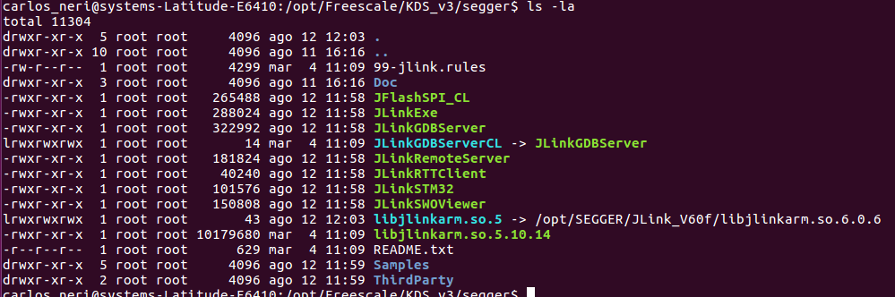

4.- Replace the Segger files available on /opt/Freescale/KDS_v3/segger with the ones installed by the Segger package on /opt/SEGGER/JLink_V60f. Here's a screenshot of what was changed (look for the ones modified on Aug 12th):

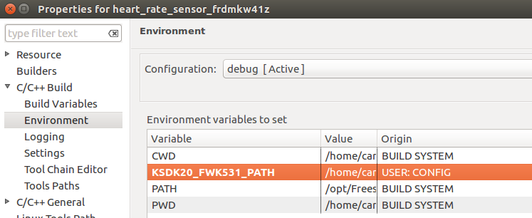

5.- Open KDS and import the project that you want to test, in this case, I used the Heart Rate Sensor. Once you open it, you'll see several warnings of missing paths. These are caused by an environmental variable called KSDK20_FWK531_PATH, which in Windows is created as a system variable. Create the variable on KDS at Project Settings->C/C++ Build ->Environment. Make sure to point it to {KW41 ConnSW 1.0.1}\KSDK_2.0

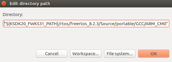

6.- Since Linux is more picky with file names and paths in lower/upper case, you'll find some issue with it, one of them is on the include paths, where Windows setup "gcc" but in the file system is actually GCC. Make sure to update that path at Project Settings->C/C++ Build ->Settings->Cross ARM C Compiler->Includes:

johncharlton
This helped me to get the debugger working in Ubuntu Linux 14.04.  After installing the segger drivers they were placed in /opt/SEGGER/JLink_V612c.  I renamed the KDS /opt/Freescale/KDS_v3/segger path to segger_kds then replaced it with a symbolic link to the Segger tools: segger -> /opt/SEGGER/JLink_V612c.  I added a symbolic link: JLinkGDBServerCL -> JLinkGDBServer to the Segger tools and everything worked.
