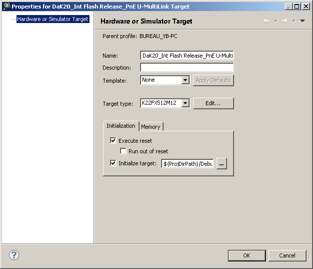

So, I spend a day to clone + addapt the librairies and I've just created a small hello world project, compiled it and ... tried to dowload it to the target (my custom board or the FRDMK22).
It's just not possible because there is no choice to select a K22FN120 in the "Target type" control :
I tried with different target (K22FX512M12, K22FN1M0M12), but no ways...
Tool : Pod PeMicro Multilink Universal or FX, SWD mode.
I don't understant why FREESCALE had stopped MQX for KDS which is not a professional tools for me...
Please, help me to find a solution, I tried KDS with PE, without PE, but it's not for me. I need to use MQX with new Kinetis CPU (K22 or newer).
If you have a real solution to make clones for new CPU and after can program / debug boards, I will be very happy...otherwise I would find my happiness elsewhere, after more than 20 years with MOTOROLA / FREESCALE...

Add :
- Download executable in RAM is OK
- I think there is  a problem with type of FLASH : K22FN512 seems to be FTFA (not FTFE).
How create and add a new target type in the HW target ?
Yvan

Found how to program K22FN512 even if CW is not done for it ;-)
1. Pemicro site : P&E Microcomputer Systems to dowload algo files
2. Extract the one you want to use (ex : freescale_k22fn512m12_1x32x128k_pflash.arp for my case)
3. Debug configuration => Target settings edit => Advanced programming options => Use alternative algorithm and select the wanted file.
