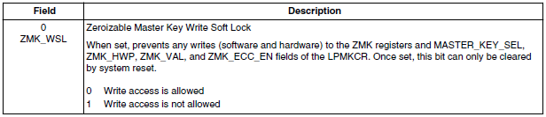

I've been able to successfully setup HAB on our board with a V1.1 Vybrid processor.  I'm able to boot a application that has been signed with the CST.  However after booting my signed application I'm  unable to set the SNVS ZMK.  The problem is that SNVS_HPLR - ZMK-WSL = 1.
When I read the text for that for that field it says the following:
How do I clear the Write Soft Lock with a "system reset"?    I've tried issuing a SW Reset from the SRC without any luck.
Below is a dump of SNVS registers immediately after boot.

The problem with the ZMK_WSL = 1 being set when leaving the bootrom was because the Code Signing Tool (cst) file needed to have Unlock commands added (HABCST_UG.pdf - Section 5.2.17).
By adding unlock commands for SNVS I was able to set the ZMK.

By "Open" to "Closed" I'm referring to changing the Security Configuration (Section 5.3 of the Vybrid Security Reference Manual).  The specific fuse that was blown is "SEC_CONFIG" discussed in section 8.5.14.
We also tried to assert reset via RESET_B but that didn't seem to help clearing the ZML_WSL bit.
Note:  Section 13.5 - SNVS reset and system power up -- has a table that indicates all SNVS_HP and SNVS_LP registers and flopgs are reset with HP Hard (ipg_hard_async_reset_b)
