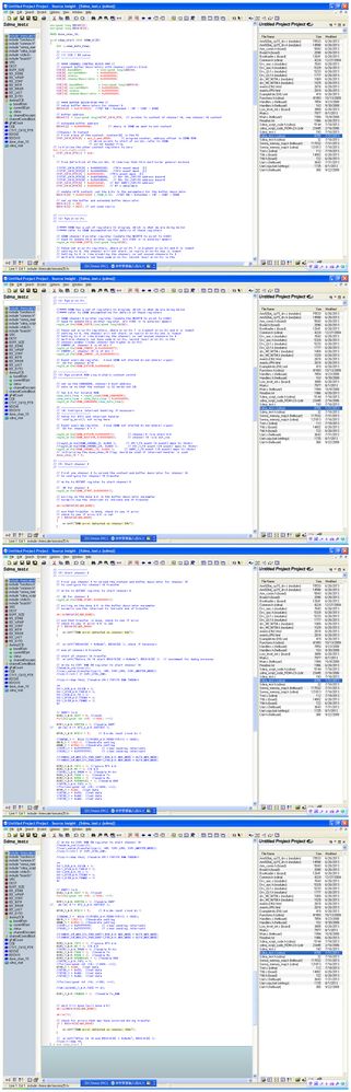

Attached is i.MX25 SDMA CSPI example (RVDS 3.1) and document with short description of SDMA basics,
this may be helpful for understanding SDMA module.

I'm trying to create a UART/SDMA sample code based on this example.
I thought not too much parameters should be modified for this purpose, but it still doesn't work now. (The transfer seems good, but UART no output...)
Here are the modified points:
=============== CSPI/SDMA =====================
1.    CTXT_CH10_PTR[3] = 0x00000200;   //R1= event mask  [I]
2.    CTXT_CH10_PTR[8] = 0x43FA4004;   // R6= SPI_TXFIFO address base+4
3.    CTXT_CH10_PTR[9] = 0x00000003;   // R7 = watermark
4.   reg32_write(SDMA_CHENBL_9, 0x400 );  // SPI1_TX event (9 event) maps to 10chnl
============== UART/SDMA =====================
1.    CTXT_CH10_PTR[3] = 0x00080000;   //R1= event mask  [I]
2.    CTXT_CH10_PTR[8] = 0x43F90040;   // R6= UART1_TXFIFO address
4.    reg32_write(SDMA_CHENBL_19, 0x400 );  // UART_1_TX event (19 event) maps to 10chnl
After starting channel 0, "D" bit and "R" bit works well. Context transfer by Channel 0 looks well.
After enabling UART/SDMA trigger, the "D" bit and "R" bit of channel 10 also looks well. But UART no any output...
Could you please show me is there any other point should be modified for change this sample code to UART peripheral function?

bwq1
Dear Igor
I realized that the author of document "iMX25 Basic SDMA activities.pdf" is you!
I have read your document and I want to say thank you because the document is very helpful to me for understanding the basic configuration method of SDMA. After reading this document I decide to follow the step listed in the document to set SDMA to let it work with UART.
There are only 4 parameters that I have changed:
4.  reg32_write(SDMA_CHENBL_9, 0x400 );// SPI1_TX event (9 event) maps to 10chnl
4.    reg32_write(SDMA_CHENBL_19, 0x400 );// UART_1_TX event (19 event) maps to 10chnl
Unfortunately, after the configuration of SDMA, the SDMA transfer seems well because the following two instructions can be through over:
while(BDCh0[0]&BD_DONE);
while(BDCh10[0]&BD_DONE);
But, UART no any output...
May I ask your help to find out where I have missed for SDMA configuration?
