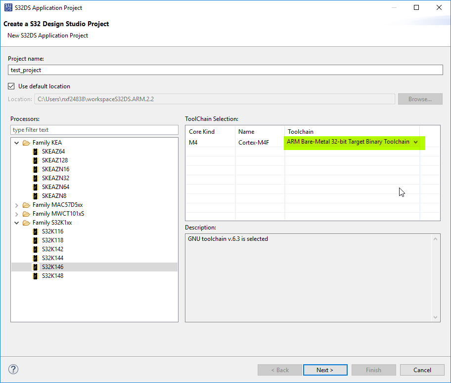

As to the problem I met: Errors in official example
I reinstall the S32DS.  This time I use the latest version "S32DS_ARM_Win32_v2.2.exe".
After installation, I have not installed any patches, like "update11".

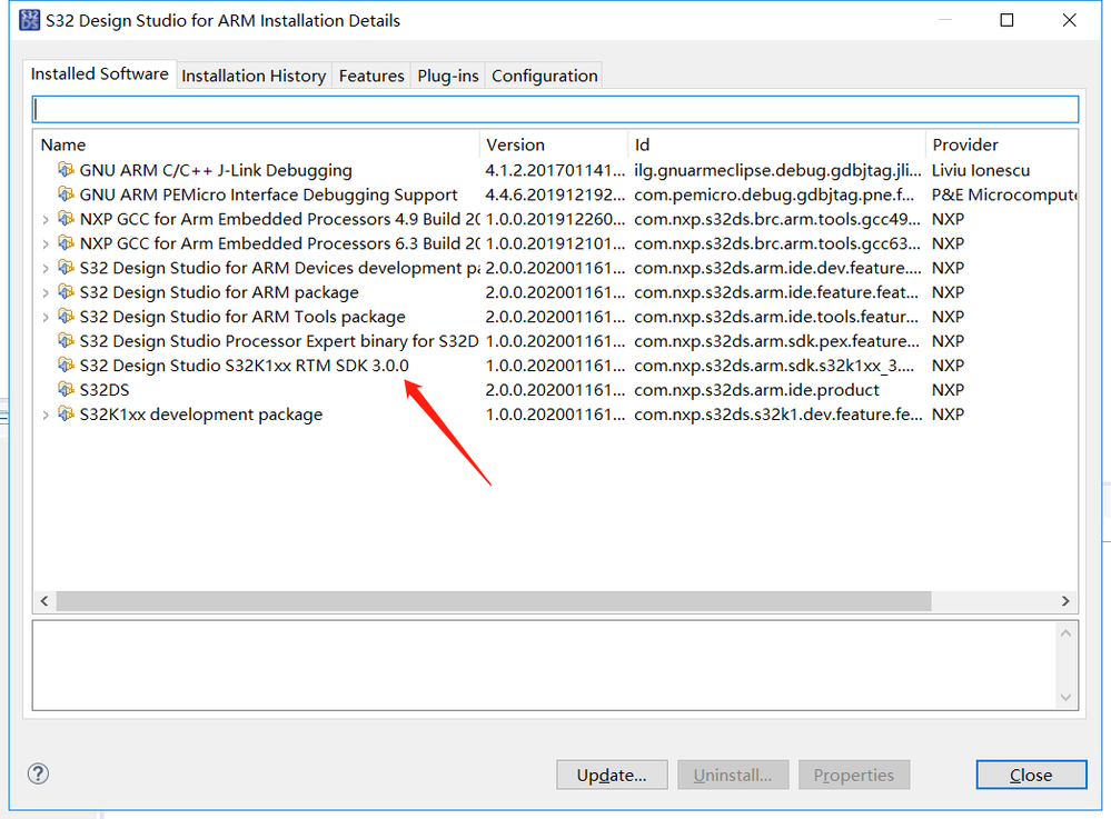

But when I try to create a new project, I cannot choose any SDKs.  Please see the picture below:
I think there is already a SDK installed in my S32DS:
Can anyone help me, why can't I choose "RTM SDK 3.0.0" in my project?
Thanks!

jiri_kral
you probably chose Standard S32DS toolchain for ARM when you created new project.. Please select ARM Bare-Metal 32-bit Target Binary toolchain.

1040180003
Thanks Jiri.
Yes, you're right.
When I choose the "ARM Bare-Metal 32-bit Target Binary toolchain",  I can see the SDK 3.0.0.

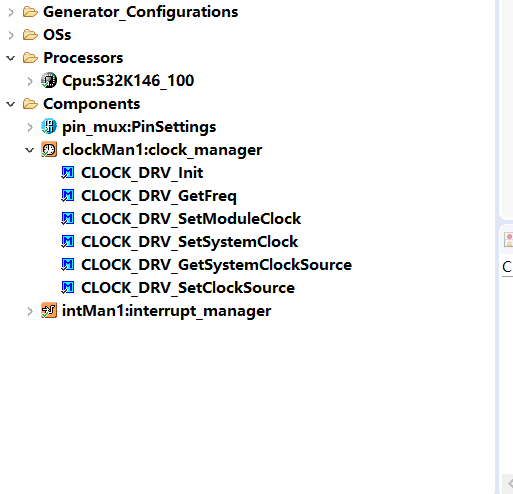

But In this way, I will encounter the previous problem again:What are the differences between different toolchains?
When the "ARM Bare-Metal 32-bit Target Binary Toolchain" is used,then I cannot find the "CLOCK_SYS_Init" function in the "clock_manager".
Do you know why?

raresvasile
The CLOCK_SYS_* API was deprecated, this is why it was removed from the list.
It can still be used, but we recommend using CLOCK_DRV_* functions.

m_mishrikey
I would recommend following:
1) Update SDK examples to match 3.0.2 command set.  Presently the examples utilize the deprecated functions, but the SDK does not include those.
