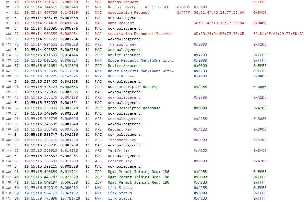

But if I re-program the Zr with simple changes or no changes at all, it cann't rejoin to network unless I factory reset the Zc.
After re-program the Zr can't rejoin the nwk even the Zc debug log says its connected. The Zr debug log says that has failed to rejoin and the packet sniffer shows the transport key but seems like Zr don't get it:

Hi Alejandro,
I think the issue you mention is caused by the fact that the NWK_Leave command was not received by the ZC (Trust Center) and as a result it sends the Transport Key command encrypted with the APS Link Key established during the previous join process. The associating device no longer has this key since it was reprogrammed and it will be unable to decrypt the Transport Key command. When a ZC receives a NWK_Leave command from a device it will erase the unique APS Link Key for that device, but it doesn't happen in this case.
This is a feature that may be controlled through the BDB_SET_DEFAULT_TC_POLICY macro (bdb_options.h).
Setting BDB_SET_DEFAULT_TC_POLICY to TRUE will cause a Trust Center to send the Transport Key command encrypted with the Default Trust Center Link Key in case of an unsecured join (association) even if an unique link key already exists for that device.
Hope this helps.
