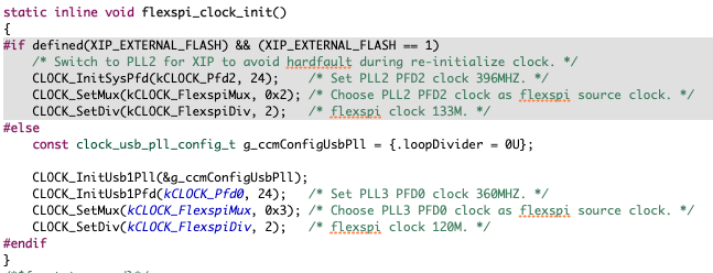

  2, About the FlexSPI clock
    You modify the wrong area, your modified point is the XIP boot clock.
    If run from the RAM, please check this code:
  FlexSPI clock is 120Mhz.
  This is my test result in the FlexSPI_CLK_A GPIO_SD_B1_07pin.
So you can find my FlexSPI clock is correct.

2. FlexSPI Clock: Thankyou - this was helpful. Because of this - I went to the MCUXpresso -> QuickStart-> Config Tool and set up Clocks appropriately.
Since the config tool generates a new clock_config.c, I commented out the flex_spi_clock_init() call from the demo.
Now I see a frequency near what i've selected on the scope.
Additionally - Now I see the proper voltage levels on my scope as well.
As this answers my original question and allows me to move forward w/ debugging via DLA - will mark as done.
