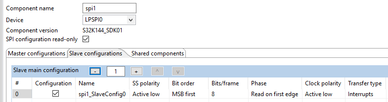

I'm using SPI slave on a S32K148EVB board.
My code is based on the spi_pal demo.
For master part I'm using either:
- (1) S32K148EVB with spi_pal demo
- (2) S32K148EVB with lpspi_dma demo
- (3) Raspberry PI
here is my slave configuration:
The slave behavior is correct with the master (1) and (2) but when using master (3) the MISO pin is not in the good state when the clock starts, resulting in bit shifts.

is there any reason why the MISO pin will not go LOW when SS pin is enabled?
the baudrate I'm using is different, for master (3) I'm using 5M and for (1) and (2) I tried 1M maximum, but I don't believe it should make a difference for MISO pin.

We found the solution by changing the slave configuration of "Phase" to "Read on second edge".
We also changed the configuration of master (3) to adapt to this configuration.
