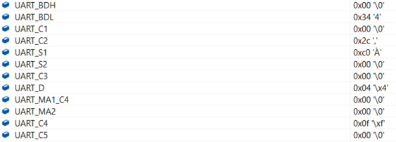

I am revising AN4379 bootloader and find some bugs. It is hard to debug step by step, since its interaction between host OS requires real-time tools. UART printf is quite useful. I have tried semihost printf, but it is too slow to print all buffer content.
So I tried my best to add UART0 on FRDM-KL25Z to print some information.
The current situation is: UART0_D can be written once, but I can not find it on my terminal software. Then all the following characters printed are blocked at:
sci.c
     uart_putchar()
     while(!(UART0_S1 & UART_S1_TDRE_MASK)){};     /*stops here after sending first char*/
     UART0_D = (uint_8)ch;
I cross-checked my previous working source for USB host project. The initialization is same.
      sci1_init()
            SIM_SOPT2 |= SIM_SOPT2_UART0SRC(1);
            SIM_SCGC5 |=
            PORTA_PCR1 |= PORT_PCR_MUX(0x2);
            PORTA_PCR2 |= PORT_PCR_MUX(0x2);
            SIM_SCGC4 |= SIM_SCGC4_UART0_MASK;
            UART0_C2 &= ~(UART_C2_TE_MASK | UART_C2_RE_MASK );
            UART0_C1 = 0;
            ubd = (uint_16)((48000 * 1000)/(UART_BAUDRATE * 16));
            UART0_BDH = UART_BDH_SBR(((ubd & 0x1F00) >> 8));
            UART0_BDL = (uint_8)(ubd & UART_BDL_SBR_MASK);
            UART0_C2 |= (UART_C2_TE_MASK | UART_C2_RE_MASK );
How to set UART0_S1_TDRE_MASK to (1) after sending first one?
According to its reference manual, to clear UART0_S1_TDRE, write to UART data register (UART0_D).
0: Transmit data buffer is full
1: Transmit data buffer is empty
More interesting point, when I manually enter characters into UART0_D in register window, they are printed out on terminal window. What's different between manually entering and programmatic way?

I see this same problem with an MKL16Z4 when I go to do the first ping response in the boot loader.
I tried dropping my baud rate to 9600, but it made no difference.
My call stack looks like:
freedom_bootloader.elf
Thread #1 (Suspended : Signal : SIGINT:Interrupt)
LPSCI_WriteBlocking() at fsl_lpsci.c:527 0x329c
uart0_write() at uart0_peripheral_interface.c:245 0x1188
serial_send_ping_response() at serial_packet.c:346 0x5d8a
read_data_packet.5051() at serial_packet.c:456 0x3d16
serial_packet_read() at serial_packet.c:161 0x5a82
bootloader_command_pump() at bl_command.c:235 0x1f18
bootloader_run() at bl_main.c:897 0xe04
main() at bl_main.c:911 0xe2c
where write blocking code looks like:
void LPSCI_WriteBlocking(UART0_Type *base, const uint8_t *data, size_t length)
    assert(data);
    /* This API can only ensure that the data is written into the data buffer but can't
    ensure all data in the data buffer are sent into the transmit shift buffer. */
    while (length--)
        while (!(base->S1 & UART0_S1_TDRE_MASK))
        base->D = *(data++);
and S1 is always zero.
I examined all the UART0 registers for clues, but it all seems plausible.
base:  0x4006a000
BDH   0
BDL  0x4e
C1     0x0
C2     0x2c
S1     0x0
S2     0x0
C3     0x0
D       0
MA1  0
MA2  0
C5     0
C4    0x1b
Any ideas?

mjbcswitzerland
Specialist V
Hello Don
I have attached a binary file for the FRDM-KL26Z which runs KBOOT 2.0.0 on UART0 (as well as USB-MSD [accepts binary and SRECs] and KBOOT HID on USB) - the UART part is the same as for a KL16.
When I look at the UART0 registers when it is connected they are at:
It looks like you may have a missing clock or something for the UART in your case since it looks to be signaling that it is in the process of sending something but never terminates. Your C4 is strange since it is usually 0x0f (16x oversampling) but it may be a typo and not be relevant.
The attached binary was built with the uTasker loader that has ported KBOOT functionality (in combination with various other loader modes that can be used at the same time) to almost all Kinetis  parts [http://www.utasker.com/docs/uTasker/uTaskerSerialLoader.pdf]. It is a smaller footprint version using a small OS that makes code much simpler to maintain, customise or extend and allows KBOOT operation to be tested in its Kinetis simulator. Since its drivers automatically match to the part no development/porting work is required when moving between chips types.

I got it.
I changed the sci_init() as following:
//SIM_SOPT2 |= SIM_SOPT2_UART0SRC(1);
SIM_SOPT2 |= (SIM_SOPT2_UART0SRC(1) | SIM_SOPT2_PLLFLLSEL_MASK);
I found because SIM_SOPT2_PLLFLLSEL_MASK setup will influence UART0_S1_TDRE to 1.
But IRC should be all right for UART0, isn't it?

how do you solve More interesting point, when I manually enter characters into UART0_D in register window, they are printed out on terminal window. What's different between manually entering and programmatic way?
I wrote code in polling method inside while loop. it is always printed out different chars on terminal windw
Please give some hint

I met similar issue before, I doubt VCP on FRDM have bug on some rate for some chars, like identify 0x00 as 0x80. My solution is changing to slower baudrate. From 115.2Kbps to 57.6Kbps. It dismissed.
Also I do find some threads discussing about UART bugs on silicon. Please search the community.
Or you can give up VCP to route UART to other TTL interface like PL2303/CP2102 to cross check.

I have following code for your reference.
main()
     sci_init();
     printf("balabala");     /*UART not working */
     usb_init();      /*PLLFLLSEL is enabled here*/
     ....     /* where I start to enter data into UART0_D */
Because PLLFLLSEL is enabled by USB part. I actually stops after running USB init code, and found manually entering data into UART0_D is working.
Then after several trial, I realized some magic code is inside the USB part, step by step debugging, locate the PLLFLLSEL bit.
