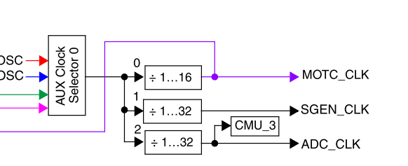

FlexPWMs run with motor control clock (MOT_CLK) with 100MHz frequency:

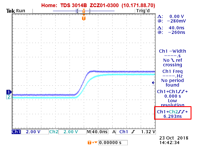

Below is figure representing External synchronization of 2 PWM (on this frequency I have 2 clocks delay between synchronization)
With adjusted FlexPWM0 channel A0 init value by 2 clocks I have reached following results:
