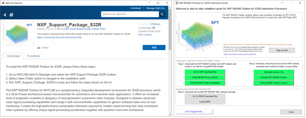

For more details, features and how to use the new functionalities, please refer to the SPT2.X Toolbox User Guide document attached. MATLAB® Integration The NXP Model-Based Design Toolbox extends the MATLAB® experience by allowing customers to evaluate and use NXP’s S32R MCUs out-of-the-box with: - NXP Support Package for S32R Installer Guide Add-on allows users to install NXP solution directly from the Mathwork’s website or directly from MATLAB IDE. The Support Package provide a step-by-step guide for installation and verification.
