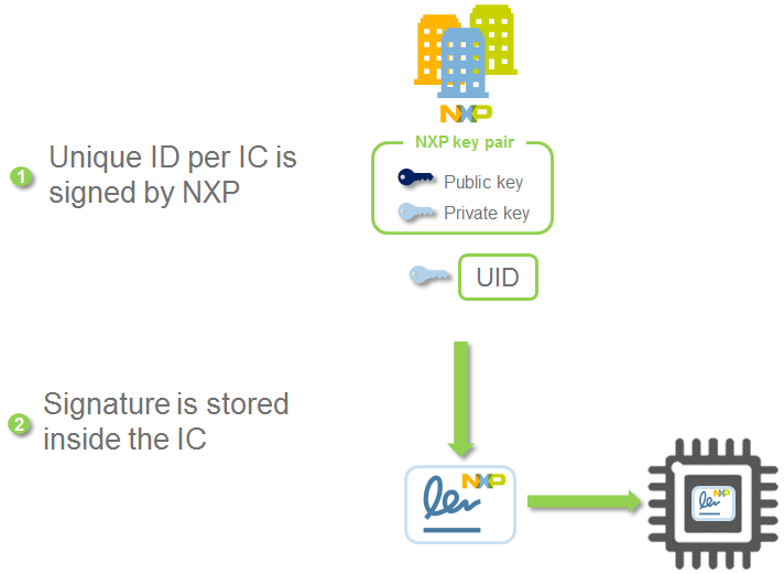

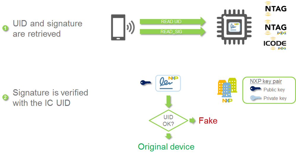

NXP originality signature
The originality signature implemented in NTAG and ICODE families is based on standard Elliptic Curve Cryptography. NXP generates a ECC key pair (a public and a private key) that are stored in a secure server. In asymmetric crypto, a signature is generated by a signing algorithm given a message and a private key. During production, NXP takes care of provisioning a die-individual signature in each IC. This signature is generated using the tag’s UID and the NXP private key. Since each tag has a different UID, a unique signature is stored in each tag. Therefore, the tags leave the NXP factory already with this unique signature pre-programmed in the IC memory.
These pre-provisioned tags are integrated by OEM into their final devices & accessories. On the field, the originality signature verification process is as follows:
  1. First, the reader unit reads the tag UID.
  2. Second, the reader retrieves the tag signature with the READ_SIGNATURE command.
  3. Third, the reader can verify this tag originality signature using the corresponding ECC public key and the tag’s UID.
With this feature, it is possible to verify with confidence that the tag is using an IC manufactured by NXP and not a cloned IC. In case that the public key is stored in the reader, the entire process can be performed offline. The products supporting this functionality are: NTAG21x, NTAG413 DNA, NTAG I2C plus, NTAG21x F and ICODE SLIX2.

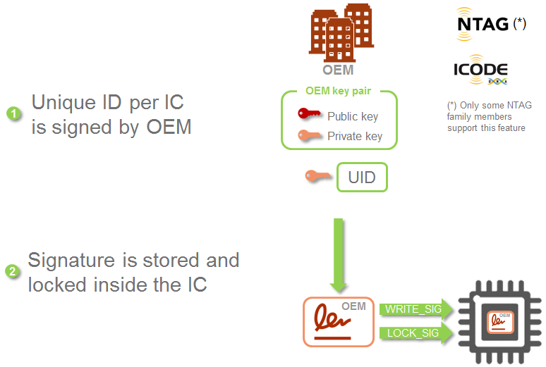

OEM customizable orignality signature
The NFC tags come pre-programmed with an NXP originality signature. However, some NTAG and ICODE family members also offer the possibility to customize the originality signature per OEM. The process is similar to the one described above, but in this case, the OEM provisions each tag with a die-individual signature, and lock it to avoid unauthorized overwriting.
On the field, the tag originality signature verification is done in the same way:
  1. The reader retrieves the tag UID and tag signature
  2. The reader uses the corresponding OEM public key and tag UID to verify the signature.
The main benefit of customizing the originality signature is that, in addition, it allows to verify that the product belongs to the OEM and not from another manufacturer. The products supporting customer originality signature are NTAG210u, NTAG 213 TT and ICODE DNA.

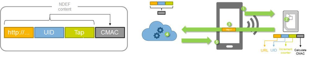

Secure unique NFC message (SUN)
One security level up, we find solutions like our NTAG 413 DNA which enable a new Secure Unique NFC message (SUN) feature. This SUN feature generates a unique, secure authentication code each time the tag is tapped. This tap-unique data consists of an NDEF formatted packet that includes:
  • A URL
  • The tag UID
  • The tap counter
  • And a AES-based CMAC calculated over the UID, the counter and the URL.
This CMAC is dynamic and changes over each tap since the counter is increased every time. The cloud service verifies the authenticity of the message with the appropriate symmetric keys. With this tag, any NFC enabled device (including Android and the recent iOS 11 devices) can automatically connect to a web based service and based on the information contained in URL, the device can check the tags authenticity and verify the information validity.

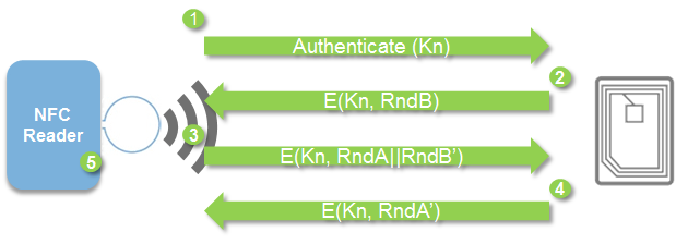

AES three-pass mutual authentication
The last tag security feature is the AES mutual authentication, which is supported by our NTAG 413 DNA as well as the ICODE DNA. The mutual authentication:
  • It is based on a shared secret key known by both endpoints
  • It allows us to verify both ends of the communication (not just the accessory).
The AES 3 pass mutual authentication consist of probing to the other end the knowledge of a secret, in this case, the knowledge of a secret AES key. As we do not want to share in plain this secret over an unsecure channel, the mechanism is based on the encryption of random challenges using this secret key. If both ends are capable of verifying this random-challenge scheme, they demonstrate that the other end knows the secret, and therefore, they prove their authenticity.

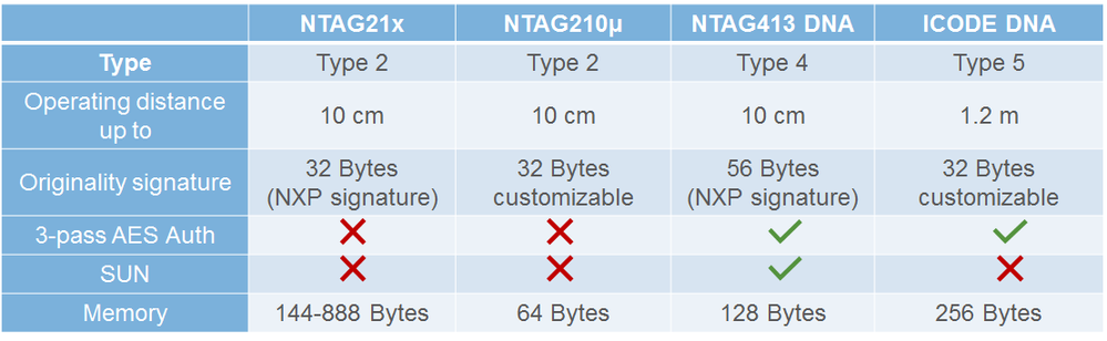

NFC tag security feature comparison
The following table consolidates the different NFC tag security options:
  • The NTAG21x support NXP originality signature
  • The NTAG210u is a cost optimized version with customizable originality signature
  • The NTAG413 DNA offers the SUN feature as well as AES authentication and encryption
  • Finally, the ICODE DNA comes with customizable originality signature and AES authentication.
Therefore, the NTAG413 DNA and ICODE DNA are the strongest authentication options that we have right now in the tag portfolio. The reading distance will influence on the decision between NTAG or ICODE:
  • NTAG is an ISO14443 compliant tag with a operating distance of a few centimiters.
  • ICODE is an ISO15693 compliant tag with an operating distance of tens of centimers.

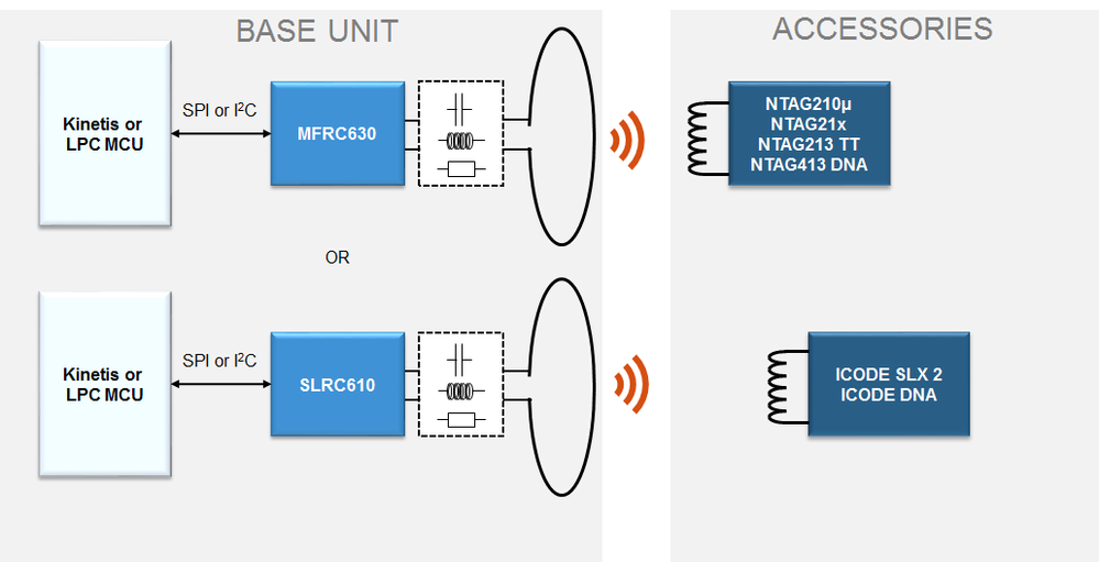

NFC frontends comparison
Regarding the NFC readers for the base unit side, we most ideal solutions are:
  • The SLRC610 plus if your application needs a reading distance of tens of centimiters. The SLRC610 supports ISO15693 and is fully operational with our ICODE family.
  • The MFRC630 if your applications needs a reading distance of a few centimiters. The MFRC630 supports ISO14443-A and is fully operational with our NTAG family.

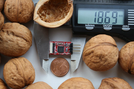

NFC Nutshell kit
This section leverages on the NFC Nutshell kit to explain how to develop your own NFC authentication solution. This kit was developeb by GMMC an approved engineering consultant of NXP. The NFC Nutshell kit is a set of hardware modules that can be used for:
  • NFC integration into new designs or retrofitting into existing products thanks to its small size.
  • It can be used to build NFC demonstrators
  • Or, it can be used for evaluation, development and testing of NFC applications
The main benefits offered by the NFC Nutshell kit are that:
  • It is made to provide designers with Nano sized hardware modules which can be configured and combined in a variety of ways.
  • It was developed with flexibility in mind so that designers can easily combined different MCUs with different NFC frontends and multiple development environment easily.
  • And, it is constructed and prepared to be compatible with NXP software tools.

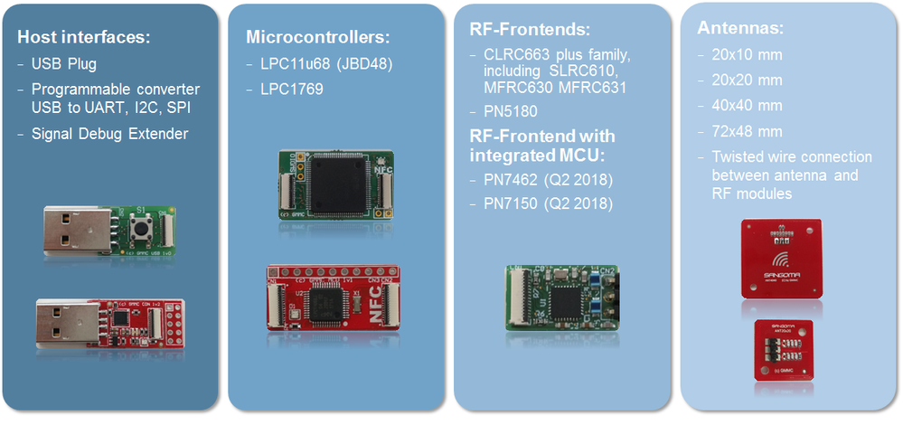

NFC Nutshell kit components
The kit includes a good bunch of modules that be divided in 4 different groups:
  • Host interface modules
    • A USB plug that bridges the USB communication to the Host MCU
    • A USB converter that is used to communicate over UART, I2C or SPI with the host MCU
    • A host interface signal debug extender
  • MCU modules:
    • LPC1769
    • LPC11U68.
  • NFC reader modules:
    • CLRC663 plus
    • PN5180
    • And soon, PN7462 and PN7150
  • Antenna PCBs of different sizes to test the performance over different antenna sizes (20x10mm, 20x20mm, 40x40mm, 72x48mm).
All the modules are connected with flexible flat cables, and the hardware components are designed for minimal PCB area to demonstrate integration into space constrained products.

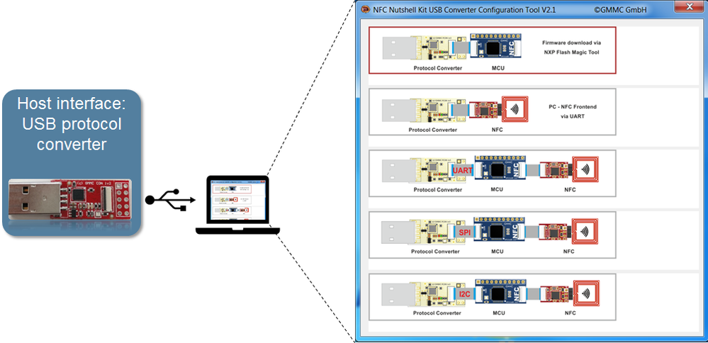

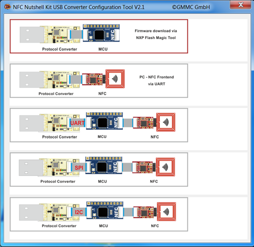

Modes of operation for the USB protocol converter module
In our case, out of the different host interface modules, we select the USB to I²C, UART and SPI converter. This single module itself has several configuration options. As part of the kit, a USB Protocol Converter Configure Tool is provided to easily configure the different operation modes of this component.
The user can open this tool and check the different options:
  • The first one is used when the converter is connected to an MCU. It configures the module for an in-system-programming, which means we can use NXP Flash Magic Tool to program the MCU flash memory.
  • The second option, the development PC communicates directly to the connected NFC frontend via UART.
  • Last, we have 3 bridge modes for single protocol conversion. The Host system can send the any command over the USB interface and it will be converted to the chosen protocol, either I²C, SPI or UART.

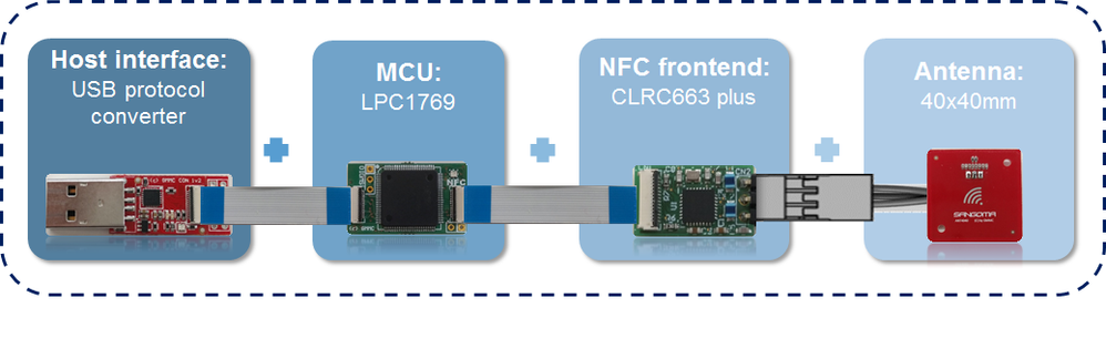

Hardware preparation
About the hardware preparation… the modules selected are:
  • The USB protocol converter module, as an interface converter between the development PC and the reader host MCU.
  • The LPC1769 as the reader host MCU
  • The CLRC663 as NFC frontend
  • And, the 40x400 mm PCB antenna.
USB converter module configuration
Before going to the software development itself, we need to configure the USB protocol converter. The USB protocol converter mode of operation configuration is a straight forward process. We just need to execute the Configure Tool provided in the kit, and select the mode compatible for Flash Magic.  In this case, this setting corresponds to the first choice as shown in the screenshot.

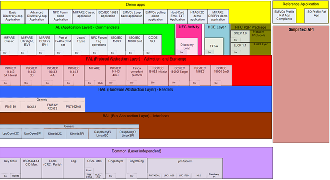

Software development with the NFC Reader Library
For the application software development, we leverage on our well know NFC Reader Library. The NFC Reader Libary is a complete API for developing NFC and MIFARE-based applications, it is free of charge and the latest release can be downloaded from www.nxp.com/pages/:NFC-READER-LIBRARY. Great news is that the NFC Reader Library has:
  • Native support for the modules we selected out the NFC Nutshell kit (the CLRC663 plus and LPC1769)
  • Supports the proximity and vicinity RF protocols.
  • And also, the commandset of Type 2, Type 4 and Type 5 tags.
Therefore, we can focus on developing the application logic rather than spending time on implementing drivers or the RF protocols. For that, we do not even need to start from scratch, because we can take as reference any of the eleven software examples. Each of these examples do not make use of the entire library, but just use the NFC Reader library components required for the use case demonstrate, allowing to reduce the overall memory footprint.

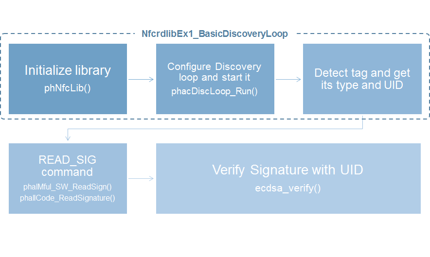

NXP Originality signature verification
We take the Basic Discovery loop example as a starting point for developing an piece of code for tag originality signature verification. If we have a look at the source code, this example:
  • Initialize the library, this is initializing the SW components that will be used
  • It configures the discovery loop for tag detection
  • Keeps iterating until a tag is detected
Once the tag is detected, we mentioned that the signature verification process consisted of:
  • Retrieving the UID
  • Retrieving the signature
  • Use a signing verification algorithm to check the signature
There are several libraries implementing ECC signature validation. As an example, we added an open source C library called nano-ECC into our project. The function call ecdsa_verify() can process the originality signature read from the tags. It is just as simple as passing as arguments, the UID the signature and the public key. In addition, the NTAG Originality signature validation application note provides code snipets and instructions for this process as well.

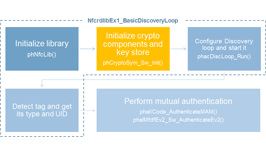

Three-pass mutual authentication
Another example for the implementation of a AES three-pass mutual authentication. Once again, we can take as a starting point the Basic Discovery loop example, which:
  • Initializes the library, configures the discovery and iterates until a tag is detected.
  • In addition, we need to add the crypto component in the NFC Reader Library handling the crypto calculation and key storage (in orange)
Once the tag is detected, we can make a direct API function call of the corresponding tag type, whether it is a Type 5 (ICODE) or a Type 4 tag (NTAG 413 DNA) there is the right function call in the lib for that. All the crypto complexity of the three pass mutual authentication is just hidden behing a single function call.

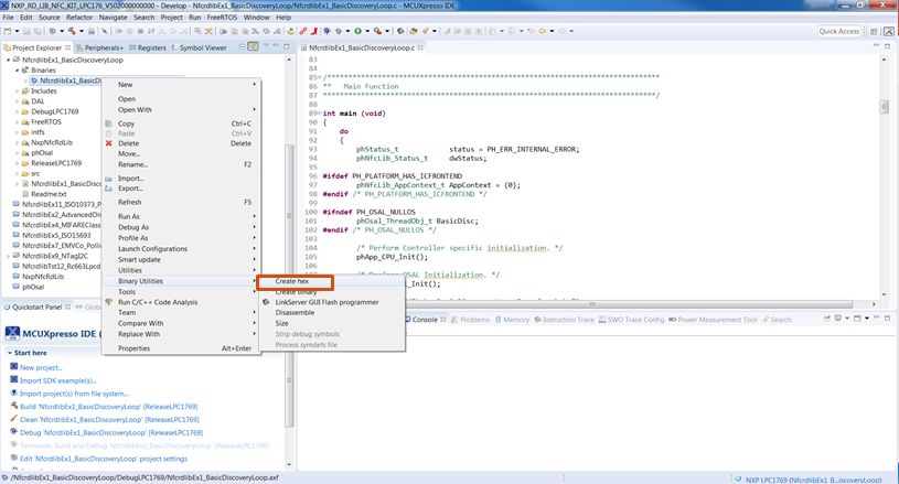

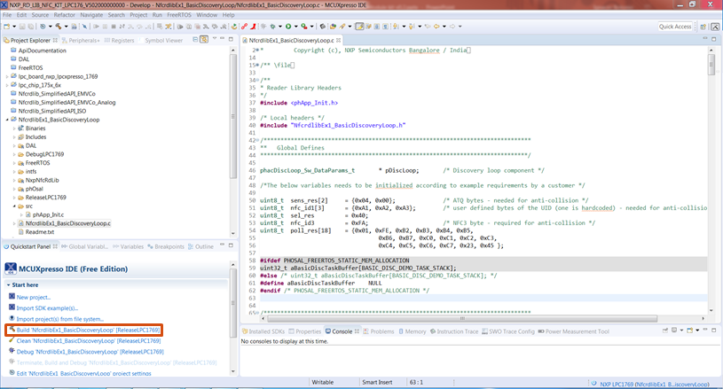

Build project with MCUXpresso
The MCUXpresso tools is used to build and compile the solution by clicking in the hammer button down in the quick start panel.
Create .hex file with MCUXpresso
After that, we can also generate the .hex file. For that, we just need to right click on the binary file, go to binary utilities and click on create hex file option.

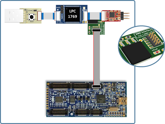

Debugging mode
Optionally, the NFC Nutshell kit also incorporates a code debugging mode. For that, there is an extra HW module compatible with LC1769 and LPC11U68 that can be used to interface with an LPC-Link2 debug probe.
