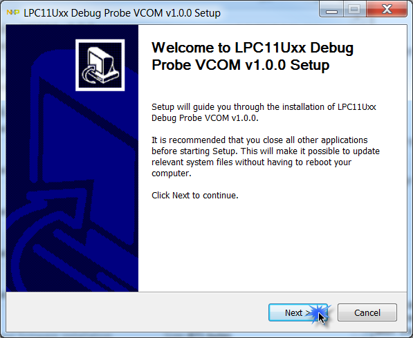

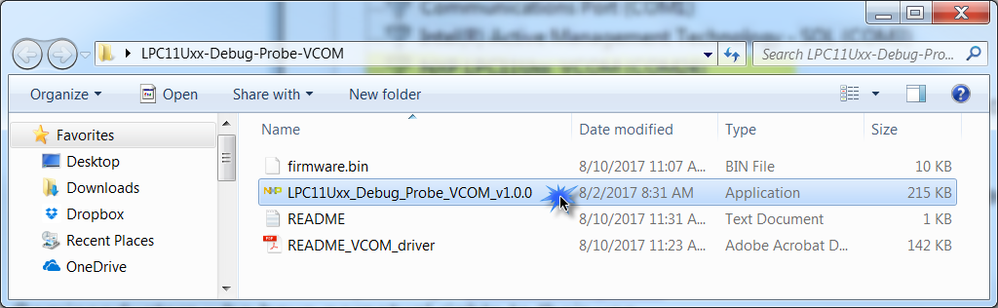

1) Unzip the Firmware and drivers and double click on the LPC11Uxx_Debug_Probe_VCOM_v1.0.0 executable:
2) The installation wizard will show up, click on Next:

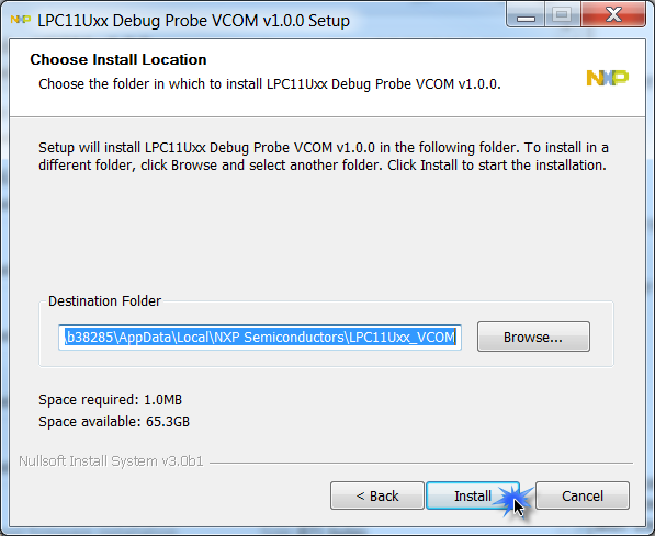

3) Choose the install location, the driver is installed by default in C:\Users\[USER]\AppData\Local\NXP Semiconductors\LPC11Uxx_VCOM\ but you can override this:

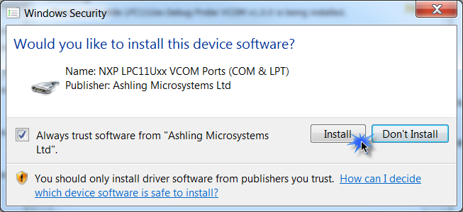

4) You will be asked to install the drivers, click on Install (These drivers were developed by www.ashling.com and are the intellectual property of NXP):

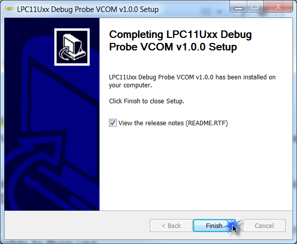

5) Finally click on Finish:

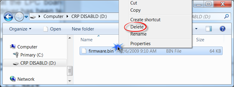

The next step is to update the debug probe (LPC11U3x) firmware:

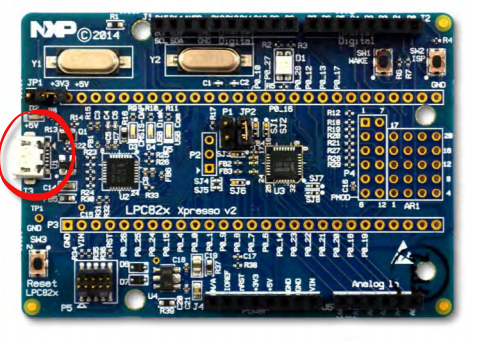

1) Unplug the usb connector.
2) Hold down the reset button and plug in the usb connector.
3) The board will appear on your system as a disk called CRP DISABLD.
4) Delete the file called firmware.bin on this disk.
5) Drag and drop the new binary image.

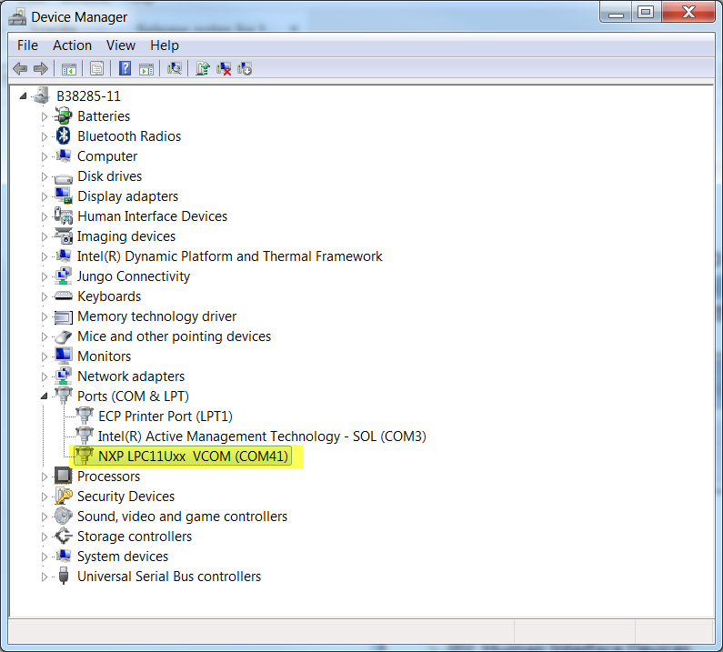

6) Connect and re-connect usb, you will have an additional VCOM port shown in Windows Device Manager:
