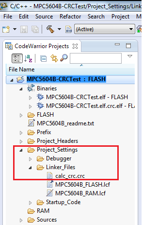

2) Create a file calc_crc.crc in the Project/Project_Settings/Linker_File directory.

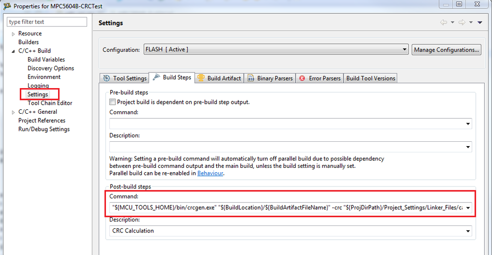

3) Open project settings, choose C/C++ Build ->Settings and add the following command to Post-build steps:
"${MCU_TOOLS_HOME}/bin/crcgen.exe" "${BuildLocation}/${BuildArtifactFileName}" -crc "${ProjDirPath}/Project_Settings/Linker_Files/calc_crc.crc" -srec "${BuildLocation}/${BuildArtifactFileName}.crc.mot" 26

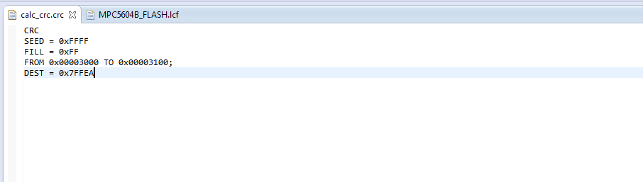

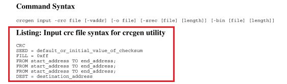

4) Open calc_crc.crc and configure required parameters. Meaning of single lines is described in CodeWarrior reference manual called Targeting_Microcontrollers
I used following code (it is only example)

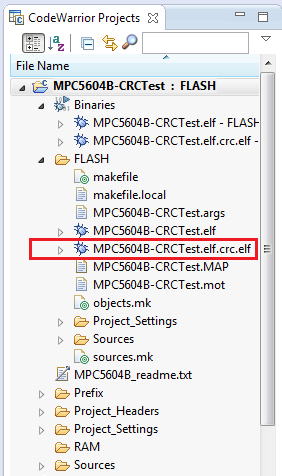

6) File MPC5604B-CRCTest.elf.crc.mot was created
Now you have s-record, which contains CRC and which could be loaded to microcontroller.
