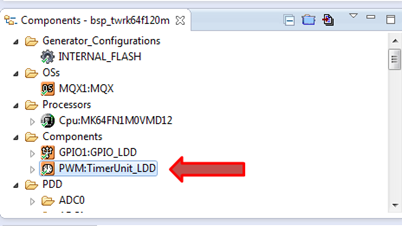

     1. Select the PWM component.
Component PWM

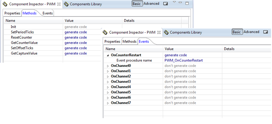

     3. Besides Properties, Components also include Methods and Events that it is possible to enable or disable.
Methods and events.
Methods are user-callable functions/subroutines intended for the component functions control.
Init: Initializes the device. Allocates memory for the device data structure, allocates interrupt vectors and sets interrupt priority, sets pin routing, sets timing, etc. If the property "Enable in init. code" is set to "yes" value then the device is also enabled (see the description of the Enable method). In this case the Enable method is not necessary and needn't to be generated. This method can be called only once.
SetPeriodTicks: The method sets timer re-initialization period (in timer ticks). This method is available only if the property "Counter restart" is switched to 'on-match' value.
ResetCounter: Resets counter. If counter is counting up then it is set to zero. If counter is counting down then counter is updated to the reload value.
The method is not available if HW doesn't allow resetting of the counter.
GetCounterValue: Returns the content of counter register. This method can be used both if counter is enabled and if counter is disabled. The method is not available if HW doesn't allow reading of the counter.
SetOffsetTicks: Sets the new offset value to channel specified by the parameter ChannelIdx. It is user responsibility to use value below selected period. This method is available when at least one channel is configured.
GetCaptureValue: Returns the content of capture register specified by the parameter ChannelIdx. This method is available when at least one channel is configured.
Events are call-back functions called when an important event occurs.
OnCounterRestart: Called if counter overflow/underflow or counter is reinitialized by modulo or compare register matching. OnCounterRestart event and Timer unit must be enabled. This event is available only if an Interrupt is enabled.
OnChannel(x): Called if compare register match the counter registers or capture register has a new content. OnChannel(x) event and Timer unit must be enabled. This event is available only if an Interrupt is enabled.

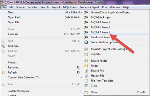

     5. The PWM driver was created. In order to use the driver it is necessary to create a new MQX project.
     6. For this example, we will edit the main task that is defined after create a new MQX project. To use PE driver some ‘handler’ variables must be declared:

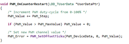

     9. Finally implement the events.

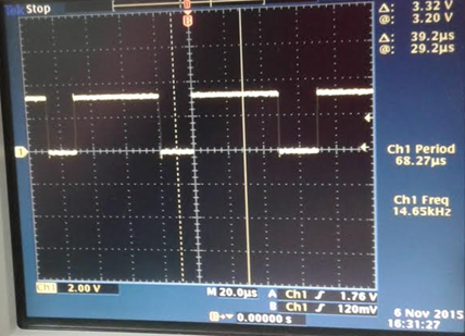

It is important to connect the tower board to the elevators and check the PWM signal on A67.

void PWM_OnCounterRestart(LDD_TUserData *UserDataPtr)
/* Increment PWM duty-cycle from 0-100% */
PWM_Value += PWM_Step;
if (PWM_Value > PWM_MaxValue) PWM_Value = 0;
/* Set new PWM channel value */
PWM_Error = PWM_SetOffsetTicks(PWM_DeviceData, 0, PWM_Value);
