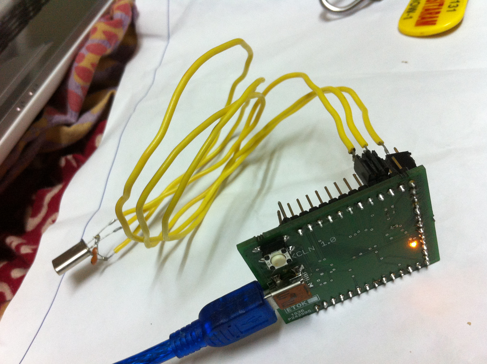

Now my project was to make custom board using MK22DX256VLF5 (48 LQFP) MCU ,my board is a rather a simple one using basic filtering circuits for powering the MCU and almost all the pinouts given as hardware pins on the dev board.Somehow I was able to flash my first blink code using Keil IDE using the OpenSDA circuitry of FRDM-KL25Z (J-11 trace cut ) with CMSIS-DAP firmware (OpenSDA app ) loaded on to it using SWD Programming.

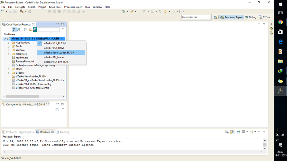

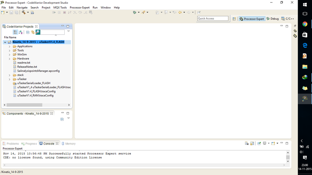

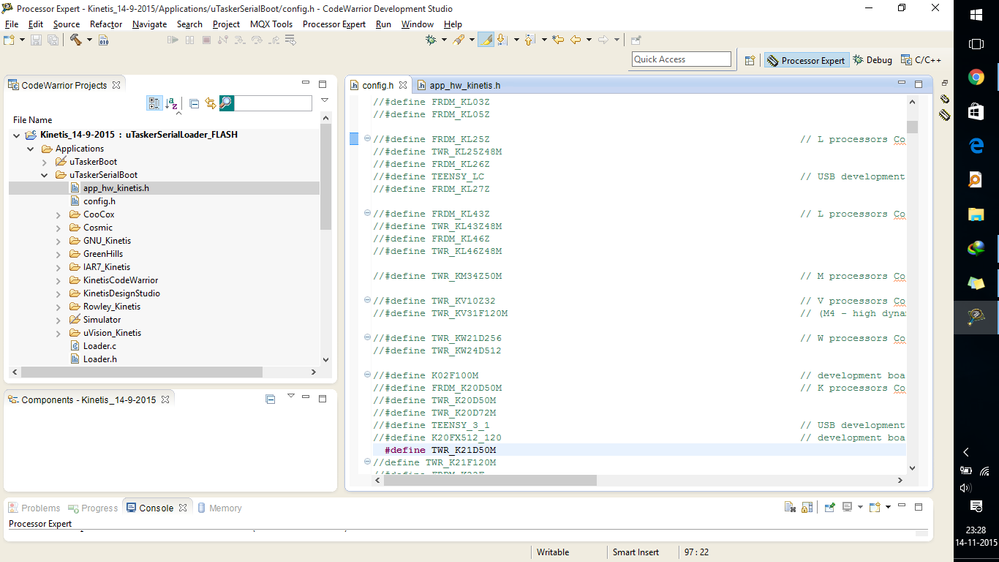

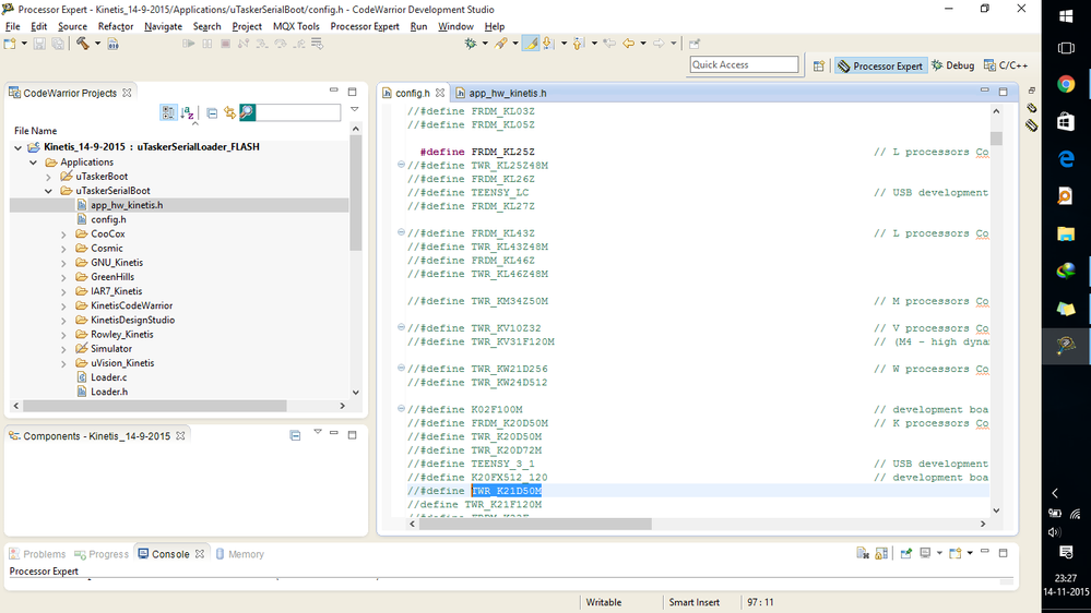

1. Lets start by downloading the uTasker project/framwork (for Kinetis ) from µTasker Kinetis Developer's Page . Then extract and copy the folder to your CW workspace ,import the project to CodeWarrior IDE, It should look like this. (I am using version 14-9-2015)
2.Next Select "uTaskerSerialLoader_Flash" from the Five build configurations (refer http://www.utasker.com/docs/uTasker/uTaskerSerialLoader.PDF  ).uTaskerBM_Loader is described in http://www.utasker.com/docs/uTasker/uTasker_BM_Loader.pdf This is a very small loader alternative that works together with an initial application. uTaskerV1.4_BM_FLASH is the application to build so that it can be loaded to a loader (including the USB-MSD one). uTaskerV1.4 is a 'stand-alone' version of the application that doesn't work together with a loader (and doesn't need a loader).If you want to build application to load using the USB-MSD loader you need to use uTaskerV1.4_BM_FLASH.
after that find the files config.h and ap_hw_kinetis.h.These files define the type of MCU you use.

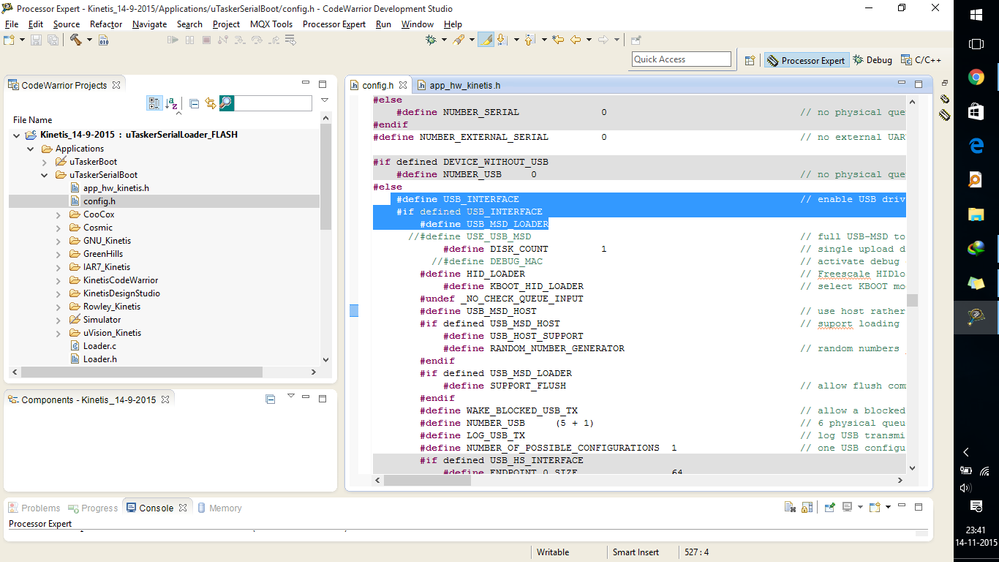

3.In config.h Select your board or MCU type or the closest MCU resembling the architecture of your own MCU. My MCU  MK22DX256VLF5 was not there so with a little help from mjbcswitzerland  I chose TWR_K21D50M Board settings as TWR-K21D50M module is a development board for the Freescale Kinetis K11, K12, K21 and K22 MCUs. (Note : Be sure to remove or comment any other defined boards )

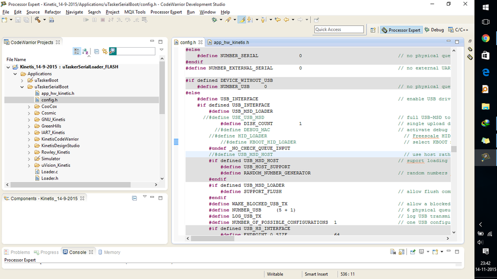

After Selecting the Board/MCU scroll down to find USB_INTERFACE and USB_MSD_LOADER and make sure that these two are defined (not commented ).This is necessary to enable USB enumeration as Mass storage device.
Also comment the following if already defined :
HID_LOADER
KBOOT_HID_LOADER
USB_MSD_HOST
This is necessary as we are using our Bootloader in MSD Device Mode not in MSD Host Mode. Also we arent using HID_LOADER and KBOOT.

Here comes an integral part of USB MSD Bootloading/Programming.You must be wondering about CRYSTAL_FREQUENCY  8000000 and  CLOCK_DIV   4  .This is the frequency of an external crystal oscillator  (8mhz) connected between EXTAL0 and XTAL0 pins of the Target MCU.If your MCU has an internal oscillator then check whether the latter is defined.
refer- https://cache.freescale.com/files/microcontrollers/doc/app_note/AN4905.pdf
         http://www.utasker.com/kinetis/MCG.html
There are two ways to be able to use USB:
1. Use a crystal between EXTAL0 and XTAL0 - usually 8MHz is used. (with or without load capacitor -both worked for me )
2. Use a 48MHz oscillator on the USB-CLKIN pin.
First one is easier and it worked for me.Since my MCU doesnt have an internal oscillator I have used and External 8Mhz crystal. If you want to use a 16Mhz crystal then just make the following changes :

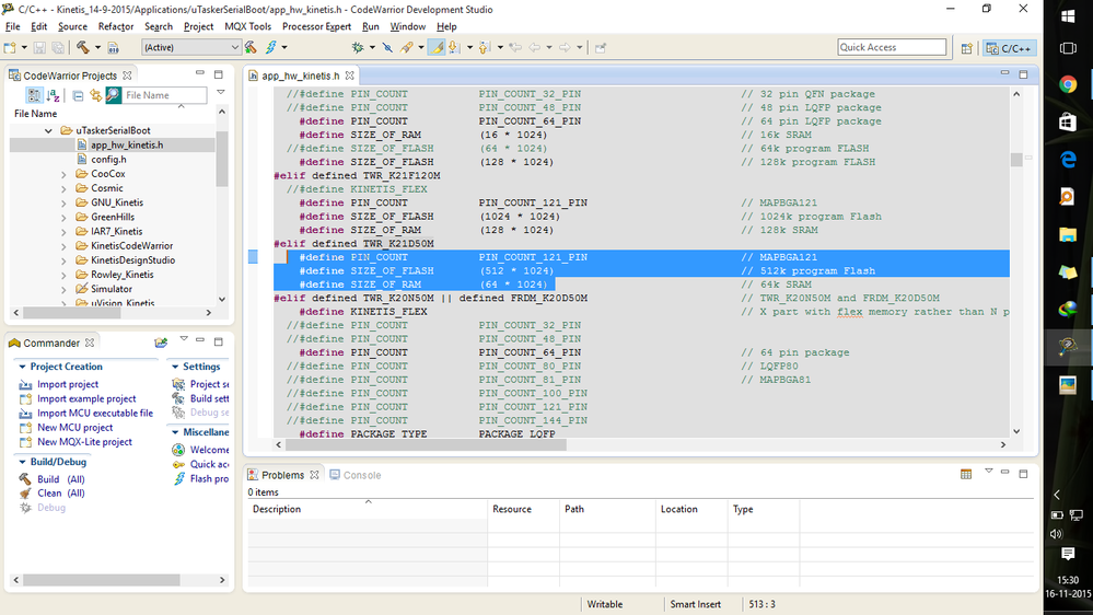

Next search for "PIN_COUNT" under your corresponding MCU/Board (mine is TWR_K21D50M).My MCU is 48 LQFP with 256kb flash and 32kb SRAM (you have to change them according to your MCU ).So I have changed the following lines
                             from
  #define PIN_COUNT           PIN_COUNT_121_PIN
  #define SIZE_OF_FLASH       (512 * 1024)
  #define SIZE_OF_RAM          (64 * 1024)
                             to
  #define PIN_COUNT           PIN_COUNT_48_PIN
  #define SIZE_OF_FLASH       (256 * 1024)
  #define SIZE_OF_RAM          (32 * 1024)

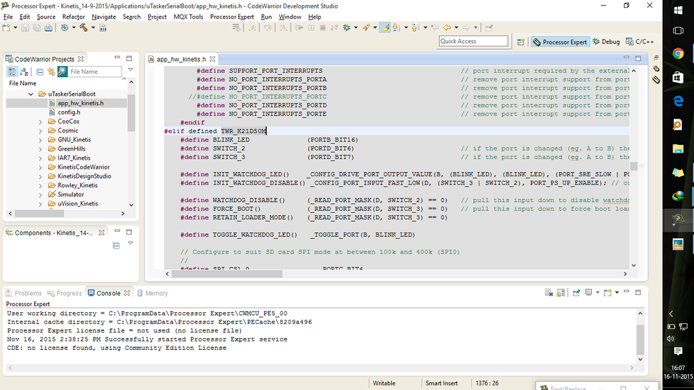

Now search for the String "BLINK_LED" under your corresponding MCU/Board ( mine is TWR_K21D50M ) .The uTasker Bootloader has a special function ,whenever it is in MSD/LOADER mode it blinks a test LED on the board.This is not important but it can be used for debugging purposes.I have a test LED on my board at PORTB16 .You can also specify hardare pins to force bootloader mode and to stop watchdog timer if you pull SWITCH_3 and SWITCH_2 down to ground respectively.I am setting SWITCH_3 and SWITCH_2 as PORTD7 and PORTD6 respectively.

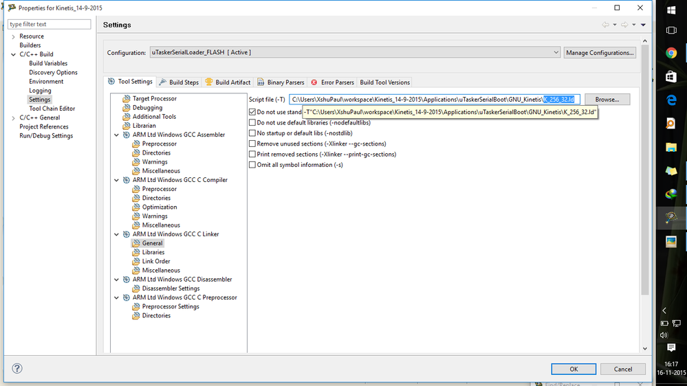

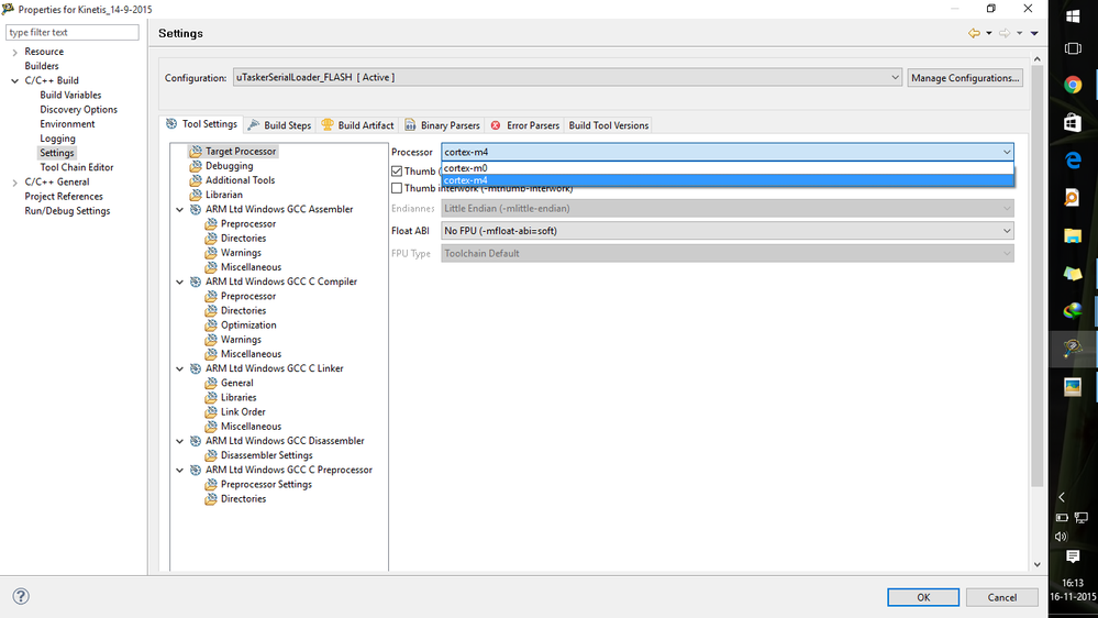

Now on the toolbars go to Project > Properties > C/C++ Build > Settings > Tool Settings > Target Processor :Change it to your MCU type (mine is cortex-m4 ) .Next go to Linker >General and change the linker script file to match your MCU's flash,RAM,Type.I have set mine to K_256_32.ld (Kinetis K type processor with 256kb flash and 32 kb RAM)
Apply your changes.Now you are ready to go.

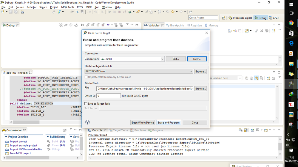

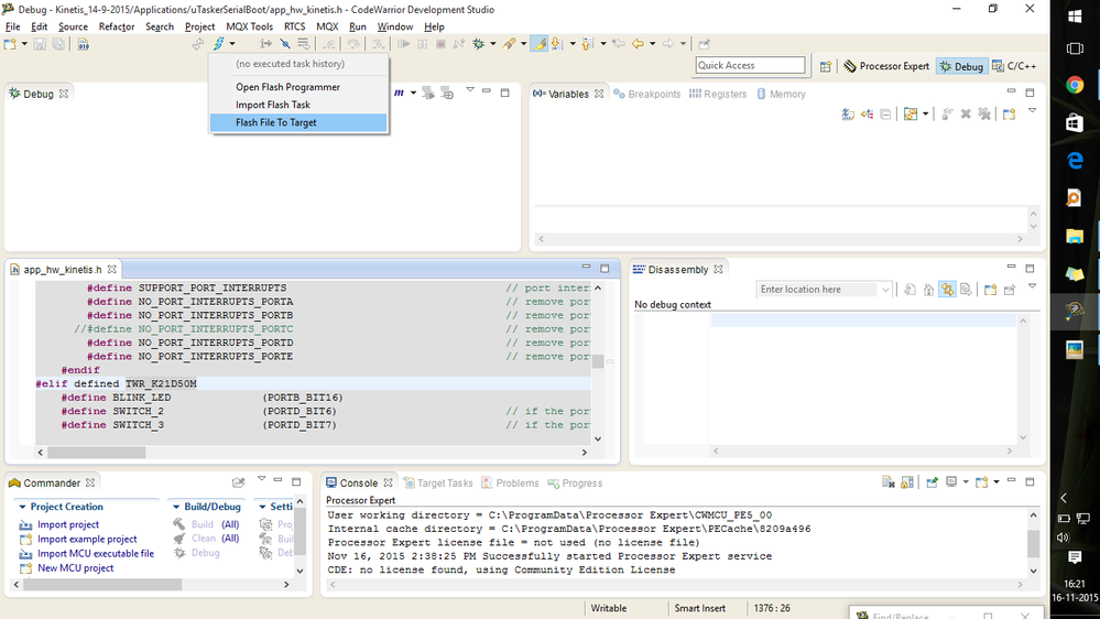

Now Click the Flash programmer icon a and Select Flash File to Target. (if your not getting the icon switch to "DEBUG" perspective view )
Now you may choose your Programmer (or emulated programmer )[connection tab] ,select the correct Flash configuration file ,then browse for the binary file that has been generated under
C:\Users\<computer user>\workspace\Kinetis_14-9-2015\Applications\uTaskerSerialBoot\KinetisCodeWarrior\uTaskerSerialBoot_FLASH\uTaskerSerialBoot.bin
and Click on "Erase and Program". You may skip Step 5 and go to Step 6.

5.1.First Enter bootloader mode and Flash the Jlink sda app into it.Connect the SWD wires from the board to your  Target MCU/Board ,also connect the target board        to the external oscillator.Also connect the FRDM's OpenSDA through USB. (A drive with the name JLINK Should come )

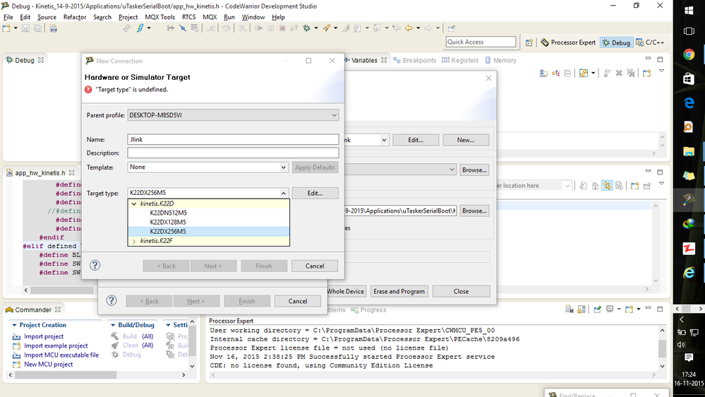

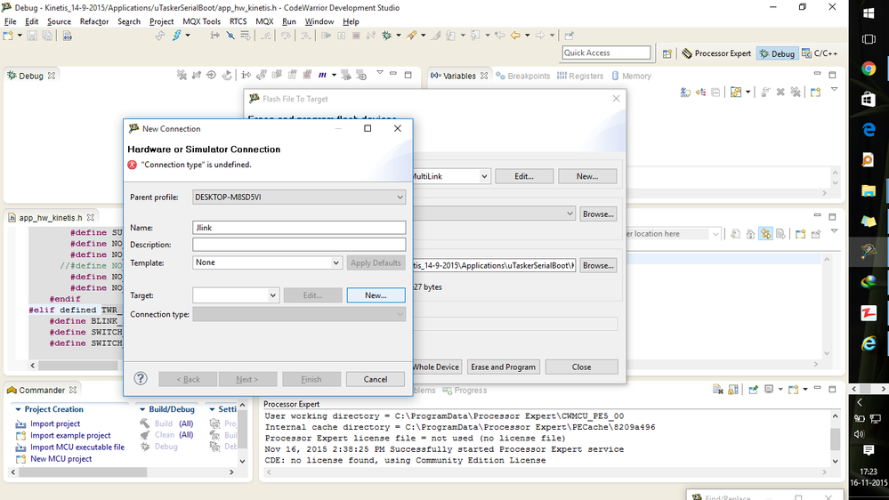

5.2. Go to Flash File to target and under connections tab click new. give any name and click new under Target Tab.Then select the target type (your target MCU ,mine is                      K22DX256M5).Then check Execute Reset under Initialization Tab. Click finish.
   Now you'll get the option to select connection type ,then choose J-Link/J-Trace for ARM and change the Debug port interface to SWD .If you get the error :connection name is not        unique then just change the name (I have used jlink1).Click Finish.
  Now I have set up my connections so I can flash the MCU with Jlink app on my OpenSDA circuitry.
