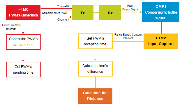

The following figure shows the application’s block diagram
Figure 1. Block Diagram

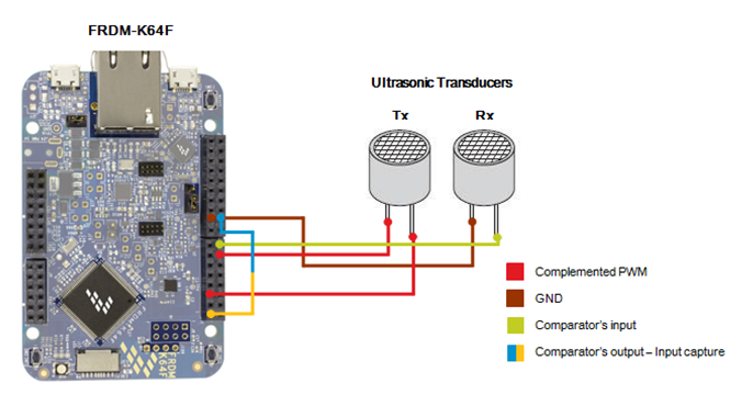

     The schematic diagram for the application is shown in the following figure
Figure 2. Schematic Diagram

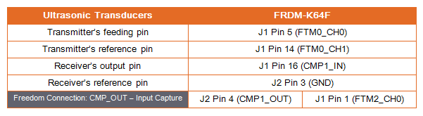

     The electrical connections needed to implement the demo are presented by this table
Table 1. Electrical connections

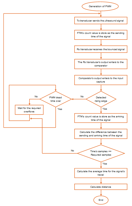

     The application’s flow diagram is displayed by the following figure
Figure 3. Flow Diagram for Distance’s Calculation

     The signal’s travel time calculation algorithm is presented in the following code snippet
void vfnGetPwmTravelTime(void) {     uint32_t wTimeDifference = 0;     static uint8_t bAux_OFCount = 0;     static uint32_t waTimeBuffer[TIME_SAMPLES];     static uint8_t bTimeSamples = 0;          bAux_OFCount = (bFtm2OverflowCount-1);          if(bFtm2OverflowCount != 0)     {         if(bAux_OFCount != 0)         {             wTimeDifference = (FTM2_MOD_VALUE * bAux_OFCount);         }         else         {             wTimeDifference = 0;         }         wTimeDifference = (wTimeDifference + (FTM2_MOD_VALUE - swPWMDeparture_CountVal));         wTimeDifference = (wTimeDifference + swPWMArrive_CountVal);     }     else     {         wTimeDifference = (swPWMArrive_CountVal - swPWMDeparture_CountVal);     }          waTimeBuffer[bTimeSamples] = wTimeDifference;     if(bTimeSamples != TIME_SAMPLES)     {         bTimeSamples++;     }     else     {         wAverageTravelTime = dwGetTravelTimeAverage(TIME_SAMPLES, waTimeBuffer);         vfnGetCurrentDistance();         bTimeSamples = 0;     } }
The travel time’s calculation algorithm is simple. If just one overflow occurred during the signal’s traveling period, the time difference is calculated as the difference of the FTM2_MOD_VALUE and the FTM2 counter value at the departure time, plus the counter value at the arriving time. Otherwise, if more than one overflow occurred then the time difference is the same as the last case, but adding the product of the FTM2_MOD_VALUE and the overflow’s counts minus 1. The simplest case is the one there haven’t been overflows, the time difference is calculated subtracting the departure counter value from the arriving counter value.
After obtaining 20 samples of travel time an average of all these values is calculated so that the time data is the most reliable possible.

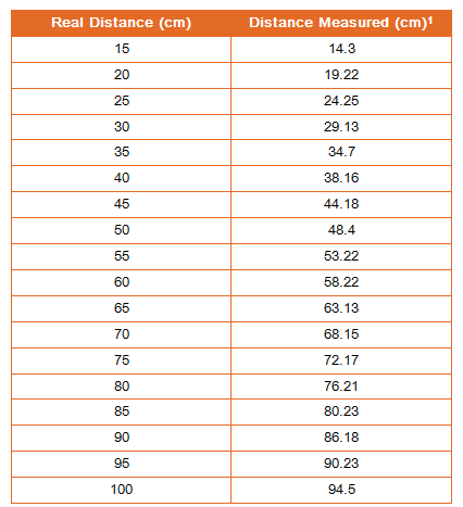

The application test’s results are shown in the following table
1The error for the Distance Measured is approximately ± 2 cm for short distances and ± 5 cm for the longer ones
Table 2. Test’s Results

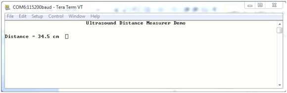

Figure 5. Example of the distance measured being shown in a console

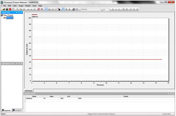

Figure 6. Example of the distance measure results at FreeMASTER

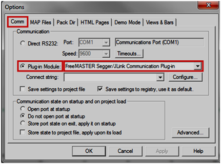

     FreeMASTER configuration
For visualizing the application’s result on FreeMASTER it is necessary to configure the corresponding type of connection for the FRDM-K64F:
          1. Open FreeMaster.
          2. Go to File/Open Project.
          3. Open the Ultrasonic Distance Measurer project from <KSDK_install_dir>/demos/ultrasonic_distance_measurer/ FreeMaster.
          4. Go to Project/Options.
       On the Comm tab, make sure the option ‘Plug-in Module’ is marked and select the corresponding type of connection.
Figure 7. Corresponding configurations FRDM-K64F’s connection at FreeMASTER
