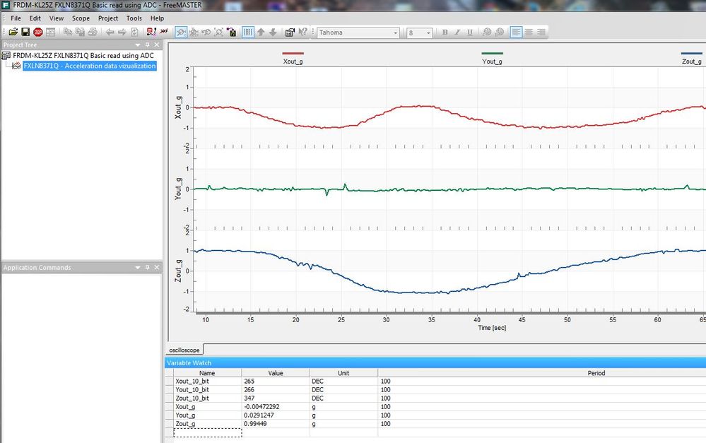

Hi Everyone,
In this document I would like to present a simple bare-metal example code/demo for the FXLN8371Q Xtrinsic three axis, low-power, low-g, analog output accelerometer. I have created it while working with the Freescale FRDM-KL25Z development platform and FXLN8371Q breakout board. The FreeMASTER tool is used to visualize the acceleration data that are read from the FXLN8371Q through ADC.
This example illustrates:
1. Initialization of the MKL25Z128 MCU (mainly ADC, PORT and PIT modules).
2. Simple offset calibration.
3. Accelerometer outputs reading using ADC and conversion of the 10-bit ADC values to real acceleration values in g’s.
4. Visualization of the output values in the FreeMASTER tool.

4. The calculated values can be watched in the "Variables" window on the top right of the Debug perspective or in the FreeMASTER application. To open and run the FreeMASTER project, install the FreeMASTER application and FreeMASTER Communication Driver.
I guess this is enough to let you start experimenting with the FXLN83xxQ family of analog accelerometers. Attached you can find the complete source code written in the CW for MCU's v10.6 including the FreeMASTER project.
