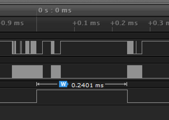

Previously I was testing without cache so I have now enabled caching (so that there are generally none, or very few accesses to QSPI Flash (program code) during general operation).
Also I have measured only the DMA transfer time (without the DMA setup).
I am intrigued by the DMA from QSPI Flash still, as shown by these two recordings:
1. I transfer 1024 bytes (as long word units) from DTC to ITC and measure 16.64us for the transfer (one long word transfer each 65ns, although the code to toggle the test output may be degrading the measured performance a bit.
On the QSPI bus i see chip selects (top line) and clocks (middle line) around the DMA transfer. Presumably the code that is executed needs to be fetched since it is not in cache.
2. Now I do the same from QSPI Flash to ITC (after the transfer I can verify that the ITC destination has the data that is in the QSPI Flash). I choose a location in QSPI Flash that has not been used by code or read before so that it is (hopefully not cached).
This time the DMA transfer takes slightly longer at 21.36us but the QSPI Flash access via the FlexSPI is not really any different.
As noted, the content in that area of QSPI Flash is now in ITC but what actually happens during the DMA process? How can the QSPI Flash content be moved there if it hasn't been read via the FlexSPI bus?
I was originally expecting attempted DMA for QSPI memory space to cause an error but it has worked. Therefore I expected that it must be reading in the QSPI flash content via FlexSPI during the process - this would be visible and slow down the transfer to at least an order of magnitude greater that the internal transfers. But again I can't see any these happening.
What is the explanation for this operation/behavior?
Mark

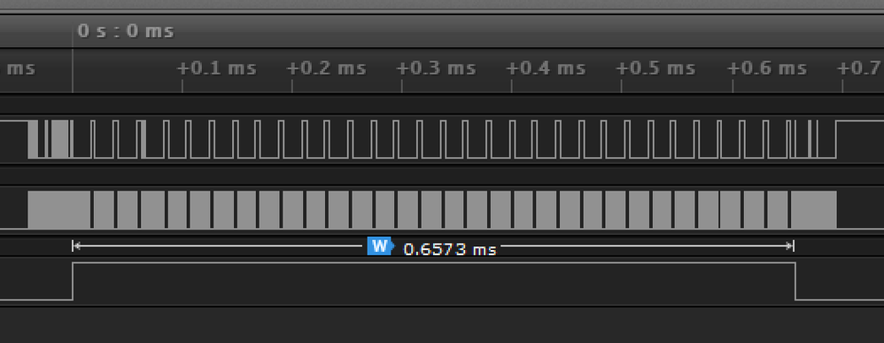

I switched form transferring 1k blocks to 32kByte blocks and now I am seeing a difference:
DTM to OCRAM transfer of 32k taking about 513us.
I notice that shortly after the transfer starts the FlexSPI activity stops; the code is spinning waiting for the DMA controller to flag that it has completed, which will be cached at this pint, with no reason to access the QSPI Flash chip.
QSPI Flash to OCRAM transfer of 32k taking about 657us (some 144us, or +28% longer).
The interesting difference is that during the wait the QSPI Flash is being accessed, which presumably means that the data is being retrieved so that the DMA controller can then perform/complete the transfer.
This is more in line with expectations but the picture is not visible with short transfers. Also the speed reduction is not great.
In the memory to memory transfer case a data rate of around 65MByte/s is seen and in the QSPI to memory it drops to about 48MBytes/s.

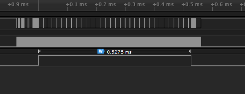

Now I am questioning the speed of memory to memory DMA transfers, so I repeated but instead of doing long word DAM transfers I did byte for byte CPU (memcpy()) transfers instead:
OCRAM to OCRAM takes 240us (133MBytes/s)
QSPI Flash to OCRAM takes 527us (60MByte/s)
Again it can be seen that data from the QSPI Flash is accessed during the process (via the FlexSPI bus).
Since I have 125MHz FlexSPI speed this doesn't seem unrealistic
But is does show that it is faster to d a simple memcpy() that to do a memory to memory transfer via DMA. At the moment I use the same code that was used in Kinetsi projects which had a good speed advantage in comparison with memcpy() so this looks like it needs to be investigated: is it a restriction that can be overcome in the i.MX RT??
