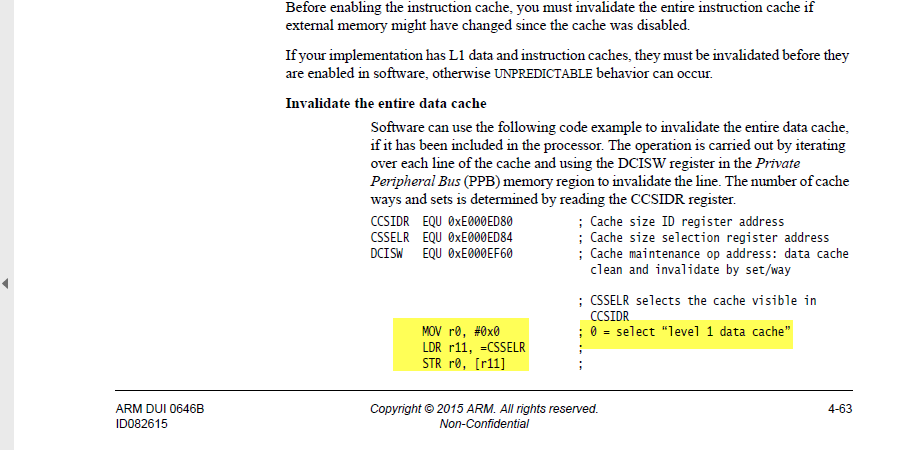

Looking at the routine to enable data cache (__STATIC_INLINE void SCB_EnableDCache (void)) I find this line of code:
SCB->CSSELR = 0U; /*(0U << 1U) | 0U;*/  /* Level 1 data cache */
According to the comment it is selecting data cache but according to the ARM documentation it is selecting instruction cache:
Therefore is the code wrong or is the comment wrong?

  You can check the same ARM cortex M7 core document: ARM® Cortex®-M7 Devices Generic User Guide, you will find the following description:
So, even the ARM document example comment, it also comment select leve 1, I think maybe it is the ARM document problem, you also can check it with the ARM side.

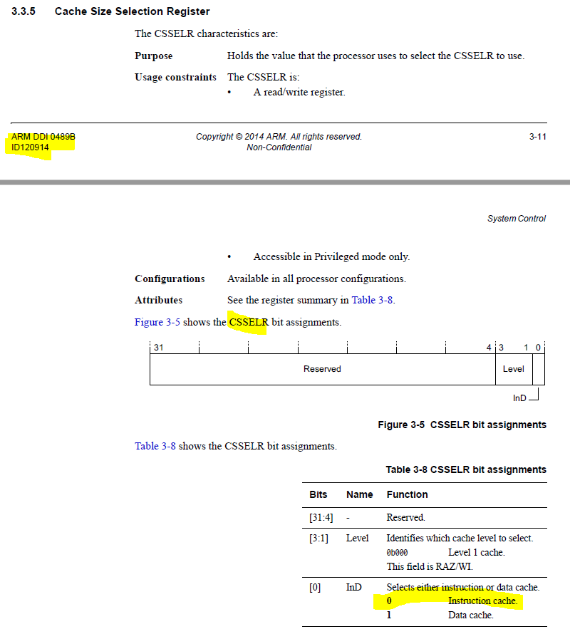

This is the document loaded directly form the ARM web site yesterday [ARM® Cortex®-M7 Processor
Revision r0p2 Technical Reference Manual]:
Here it clearly states that InD needs to be set to 1 to select data cache yet the NXP code and my experiments show that it is the other way round.

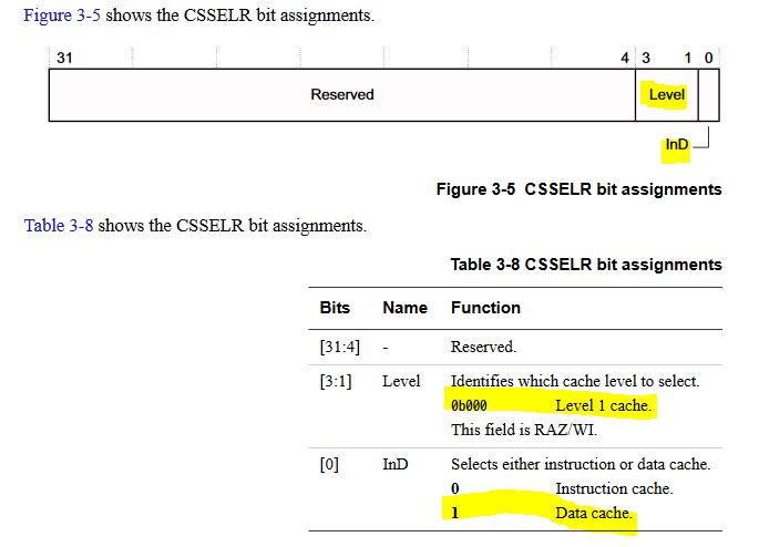

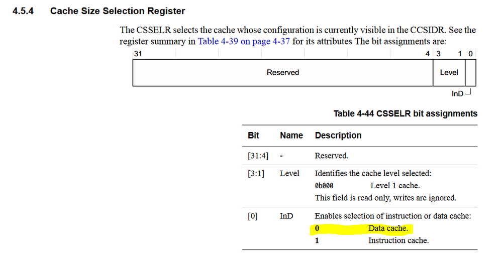

In the document that you reference "ARM Cortex-M7 Devices - Generic User Guide" one finds it inverted:
which matches with the example code and also the code in the CMSIS routine, which is used by NXP.
Code thus looks correct (and reacts I believe correctly) but the ARM technical reference manual seems to be wrong.

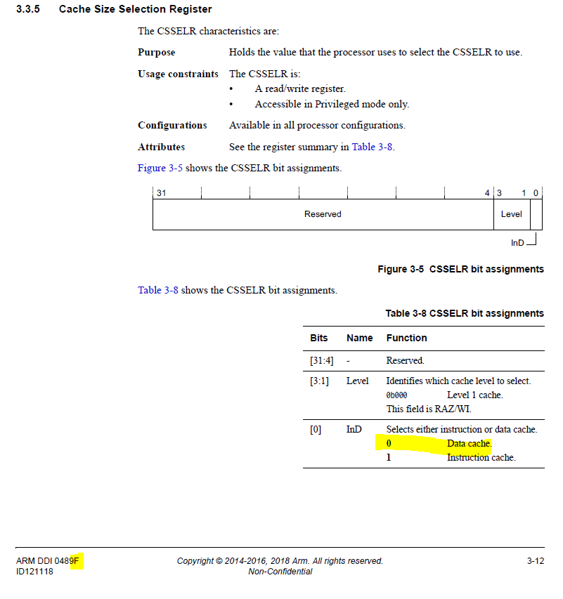

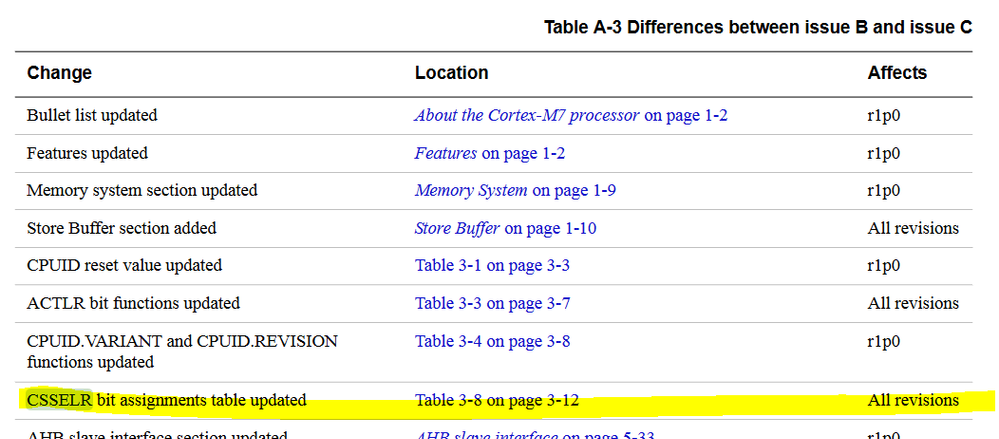

I did a bit more research and have found a newer version of the technical reference manual "r1p2"
with change-note:
Therefore it was a documentation error. I will use exclusively the newest version from now (ARM is still linking the older one at some locations at infocenter.arm)!!
