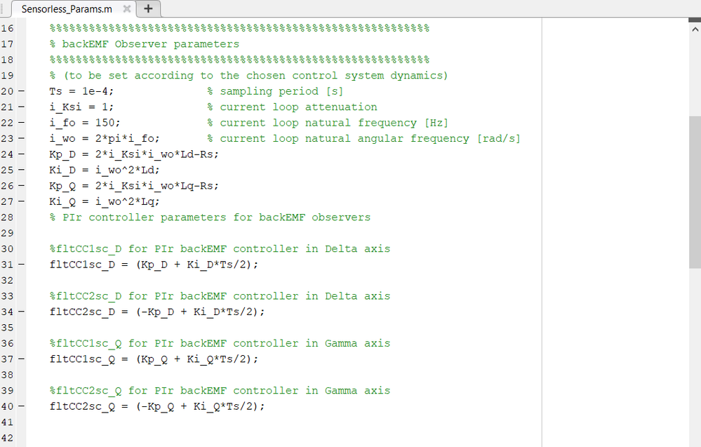

  • Sensorless_Params.m Matlab script that computes the parameters for the BackEMF and Tracking Observers discussed in Module 9: Position Observer (Part 1/2) This script is called automatically when the Simulink model is opened in MATLAB.

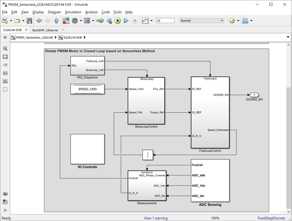

The Simulink model for the sensorless speed control of the PMSM is a combination of the model shown in Module 8: Speed Control enhanced with the observers discussed in Module 9: Position Observer (Part 1/2) . The basic control structure is very similar, hence we are not going to repeat our self but instead we shall focus on differences and new features added.
The main control structure with fast and slow control loops is shown in Fig. 1
Fig. 1: Sensorless Speed Control of PMSM Simulink Model
The main difference between this model and the one one shown in Fig. 34 within Module 8: Speed Control is the fact that actual motor speed is estimated in the Fast Loop rather than being estimated based on Hall Sensor transitions.

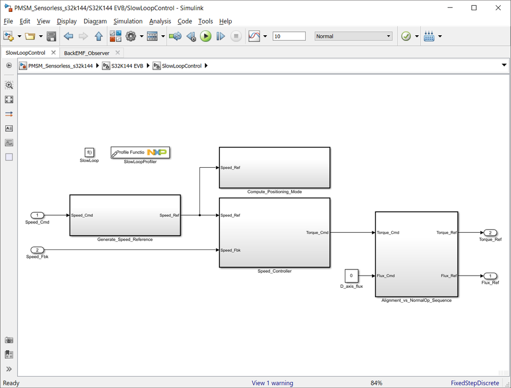

Slow Loop Subsystem
The Slow Loop subsystem has been slightly updated to reflect better the operations that takes place at each 1ms interrupt.
Fig. 2: Slow Loop Subsystem
As shown in Fig. 2, the first operation is to deal with the Speed Reference profile during acceleration and deceleration regimes. The next operation is to compute the torque command based on a Speed Controller. In parallel with the speed controller we need to monitor the Speed Reference to select the mode of operation: open loop, tracking mode and closed loop. This information is need to switch from open loop to closed loop operation. The last operation done in Slow Loop is the Alignment procedure which is done only at startup.
In this subsystem the major modifications made compared with previous model in Fig. 33 within Module 8: Speed Control  are:

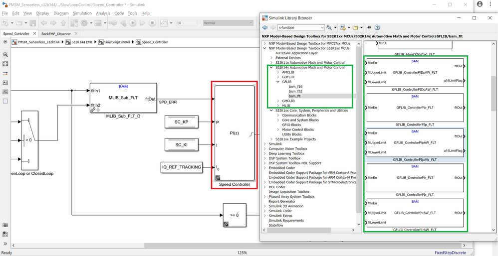

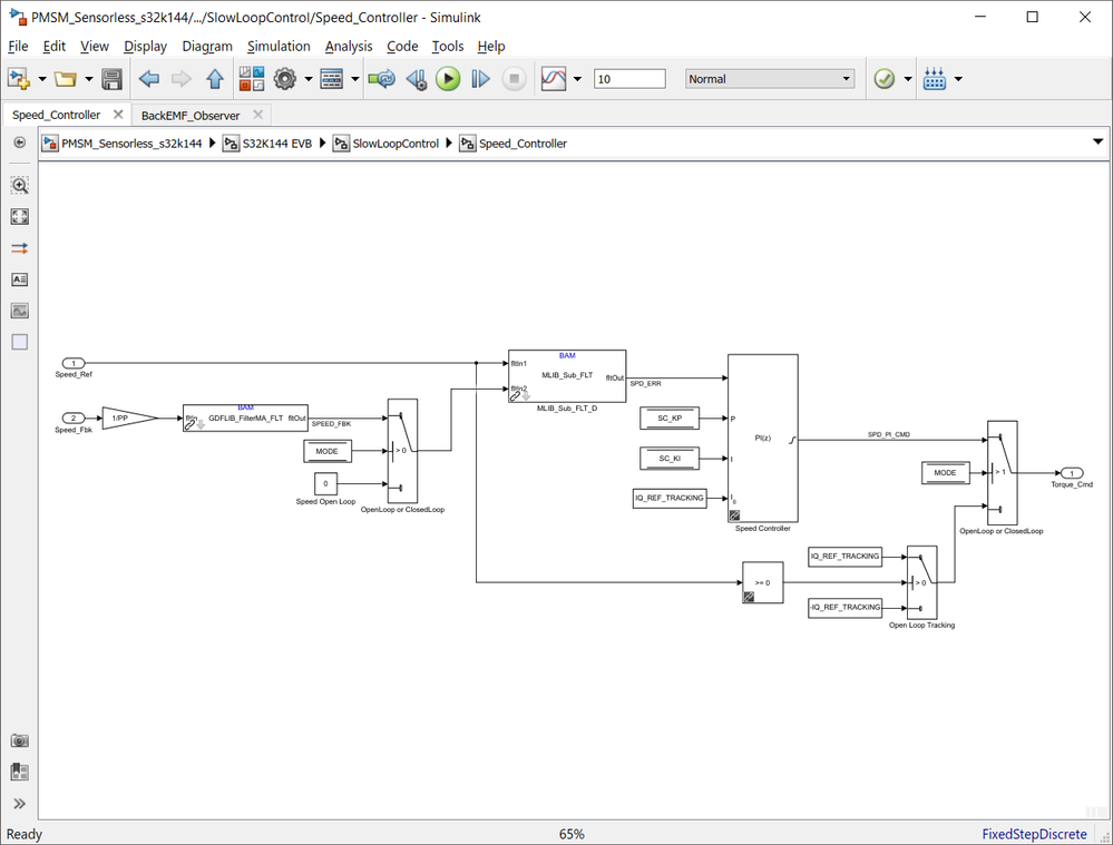

Fig. 3: Speed Controller Subsystem
  • The Speed_Fbk, estimated by the Tracking Observer needs to be translated from electrical to mechanical units and then filtered with a moving average filter.
  • The PI Speed Controller has been enhance to allow an initial value for the integral part accumulator. This is required to have a smoother transitions between open and closed loop.

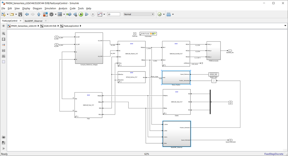

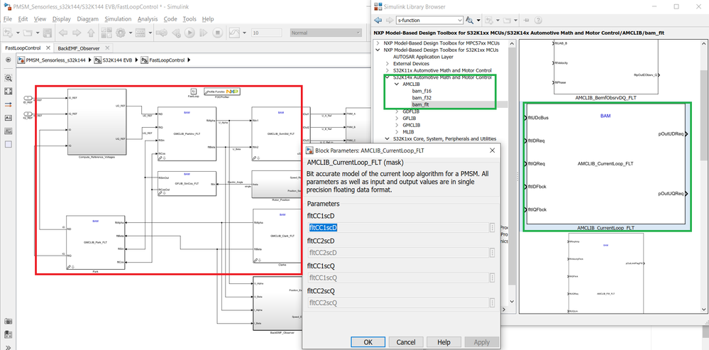

The fast loop subsystem has been optimized further for getting the best possible performance and to keep some tuning options available. Compared with Fig. 30 in Module 8: Speed Control the new model adds 2 new subsystems highlighted below in blue foreground: Rotor Position and BackEMF Observer
Fig. 4: Fast Loop Subsystem
The BackEMF Observer subsystem implements the model shown in Fig. 9 within Module 9: Position Observer (Part 1/2) but this time directly in floating point using the dedicated Automotive Math and Motor Control Library Set | NXP functions: AMCLIB_BemfObsrvDQ and AMCLIB_TrackObsrv
Fig. 5: Speed and Position Observers
The parameters for these observers are computed according with the guidelines from the AMMCLIB User Manual.
The other subsystem that has been modified is the Rotor Position, that handles the merging speed/angle between the open loop, tracking and closed loop modes of operation.

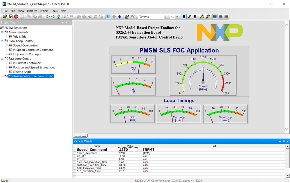

Sensorless Run Time
The FreeMASTER project is giving you access to all important parameters and variables for tuning or monitoring actions.

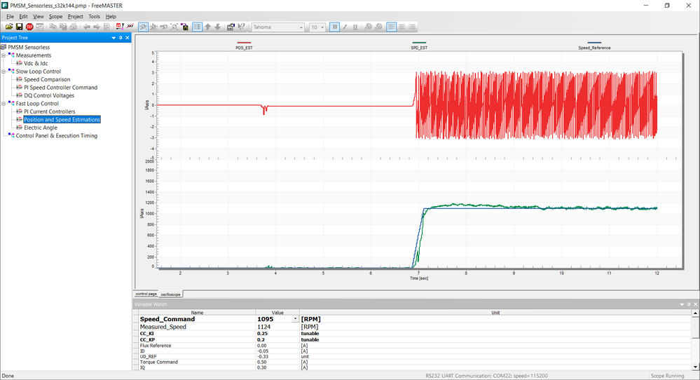

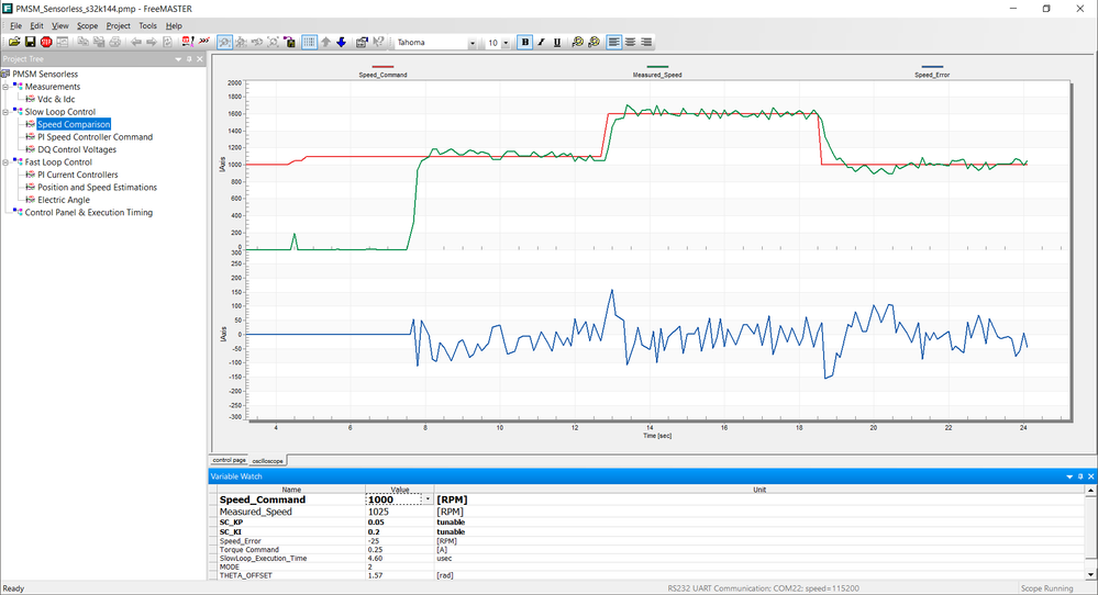

Fig. 7, illustrates a typical startup, followed by an acceleration and deceleration regimes. Throughout these profiles, the Speed Controller manages to keep the motor speed within a decent error envelope of +/- 200 rpm. If better performance is required, then the FreeMASTER can be used to tune the PI controller gains in real time.
Fig. 7: Control system response at startup and change of speeds
Further investigations and tuning may be deployed to achieved the best system stability. Fig. 8, shows the BackEMF observer output during startup of PMSM and show fast the estimator can cope with changes in the motor speed commands.
Fig. 8: Rotor Position and Speed Estimation during startup of PMSM

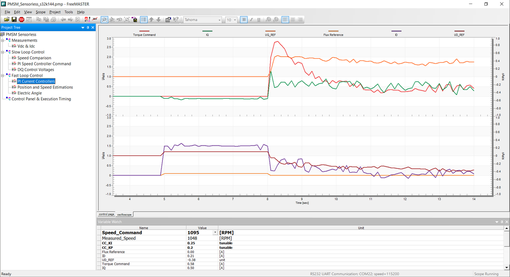

Keep in mind that there are multiple parameters that influence the system response, hence you need to have an holistic view of the entire system. Fig. 9 shows how the current controllers behaves during startup (from 5 to 8 sec on the scope) and then during acceleration regime.
Fig. 9: Flux and Torque current controllers responses

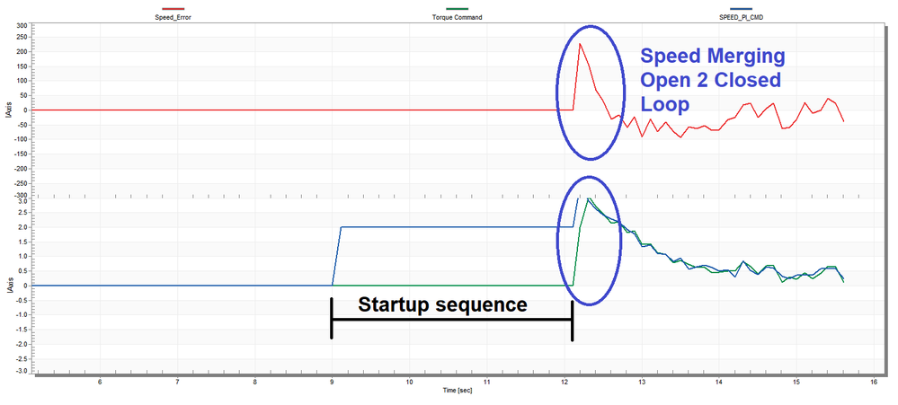

  6. The last step is to close the loop. Start with a higher merging speed and then decrease it step by step. If the transition from open to close is not happening correctly, then you need to check the speed controller tuning. Perhaps the transition between the modes creates a disturbance, perhaps the integral part is not at the level it should be from open loop as shown in Fig. 10
Fig. 10: Transition from open to closed loop

  • Optimize the application further by using the dedicated NXP AMMCLIB Controllers instead of the standard ones from Simulink. This will give a bust in performance but it will be harder to tune since the gains will be hard coded into the generated code.
  • Replace part of the control loops with dedicated blocks from the AMMCLIB/Advanced Motor Control Library blocks like Current/Speed Loops. This will make your model harder to read but more faster since the number of read/writes for data manipulation will be reduced.

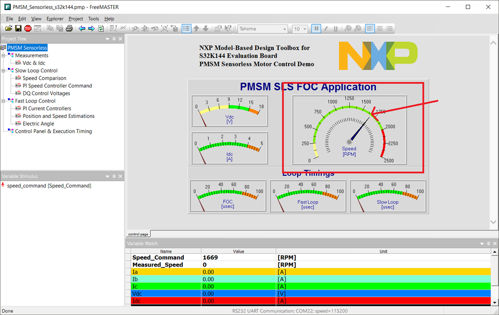

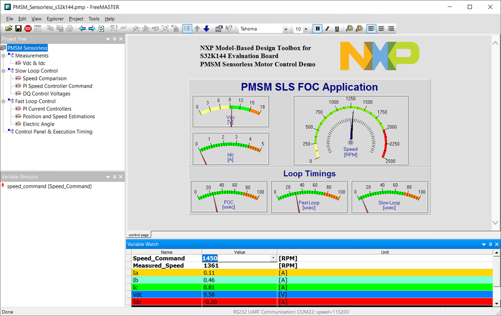

hayaoki7
Thank you for your help.
The speed detected with respect to the command value is reversed when viewed with Freemaster.
Speed adjustment is also not possible.
Hall sensor is not connected.
The MATLAB I am using is R2019A.
17,640 Views
Daniel_Popa
Hi hayaoki7‌,

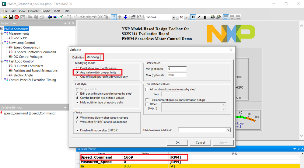

The detected speed - can't be changed. It is a value computed by the observer at each 100ms.
The motor speed can be changed via:
  • Option one - Click on the Speed Widget in the FreeMASTER
  • Option two - use the Variable Watch window
In general all the variables can be converted from read-only to read/write from Variable/Modifying tab
In this example there is no hall sensor needed - the rotor angle estimation requires only the i_a/i_b phase currents and control voltages u_alpha and u_beta. In M8 we use the hall sensor to estimate the speed because the motor do not have an encoder. If you have motor with any other type of sensor mounted - then it would be much more easier and more robust to build a motor control application.
