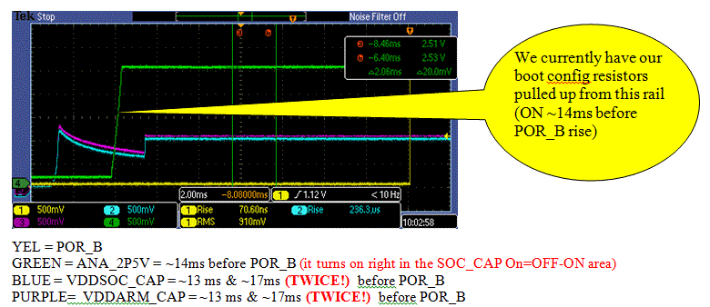

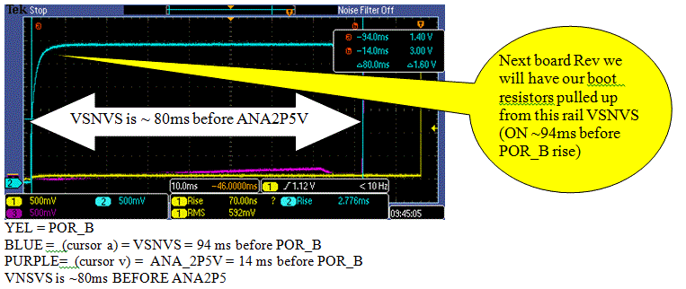

SOLUTION 1: Change from ANA_V2P5V to VSNVS for all boot config pullups (much earlier in sequence and away from strange ON-OFF-ON behavior as exhibited in the following figures)
(See Figure 1): ON-OFF-ON LDOs.  Our Config Pins appear to pull up during this transition.  Boot fails
(See Figure 2): Moved Config Pins to Much early in Boot (VSNVS) out of the ON-OFF-ON Area.  Boots reliably

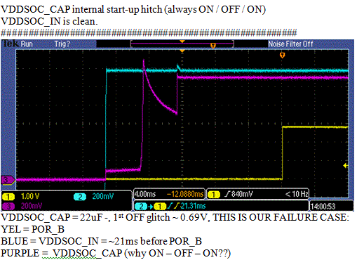

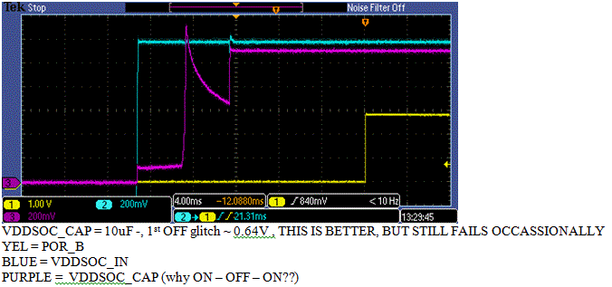

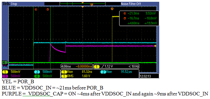

(See Figure 3): Capture showing that the VDDSOC/ARM_CAP ON-OFF-ON is internal, not a result of VDDSOC/ARM_IN.
Notes for Figures 1 - 3:
  • Documentation implies the boot config is latched at rising edge of POR_B (i.MX6Dual/6Quad Applications Processor Reference Manual Rev 2, 06/2014)
  • Currently boot resistors are strapped to ANA_V2PV which is safely stable before POR_B rising edge
  • When we change config resistors to VSNVS rail (80ms earlier than ANA_2P5V) we boot reliably
  • This seems to behave as if the boot config is being read/latched at this unstable VDDSOC ON/OFF/ON area

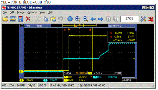

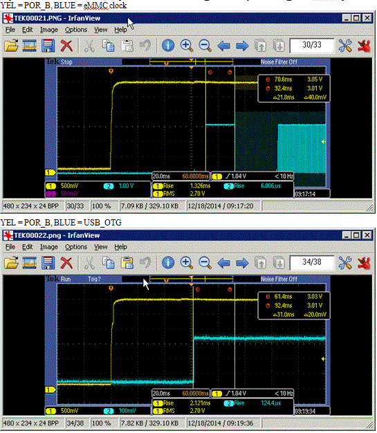

USB ACTIVITY: On Our failure boot-up case, we see USB_OTG doing something early BEFORE POR_B.  eMMC never executes.  If, with power still applied, you perform a second POR_B, then boot from eMMC always happens correctly
(See Figure 4): USB Activity before POR_B failure
(See Figure 5): Proper Boot with eMMC and USB activity as expected

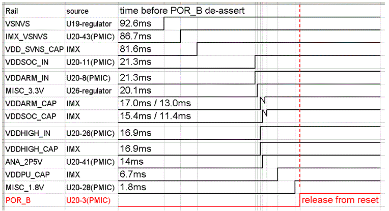

Power-up rails/POR_B sequence:
(See Figure 6): Power-up sequence/POR_B

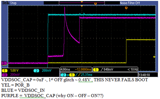

Fix #2 = We have found that reducing the capacitor on VDDSOC_CAP from 22uF to 10uF to 0uF seems to positively impact the boot (NOTE: A recent test showed one failure with a 10uF capacitor, so this is not seen as reliable).  The VDDSOC_CAP signal appears to be the one that contributes to the issue (not VDDARM_CAP).We have tested with 22uF/10uF/0uF on the VDD
(See Figure 7 - VDDSOC_CAP with 22uF Cap Fails)
(See Figure 8 - VDDSOC_CAP with 10uF Cap normally boots, but has failed at least once)
(See Figure 9 - VDDSOC_CAP with 0uF Cap boots reliably)

Q1) What would cause the VDDSOC and VDDARM LDOs to exhibit the ON-OFF-ON at power-up?  Is this a known issue or errata?
Q2) Is the ON-OFF-ON situation somehow causing the apparent early latching?  And how do we mitigate it in such a way that we guarantee a reliable boot from the config pins?

ANA_2P5V rail is generated by the PMIC "VGEN6_OUT", this rail comes up about 72ms after VSNVS and about 14mS before we de-assert POR_B.
We release POR_B about 14mS after ANA_2P5 rail, documentation states in multiple places that boot resisrors get latched at POR_B release.
Can you provide more insight about SNVS getting unexpected spike from ANA_V2P5 pull-resistors?  Could it be possible for this glitch to get something in such a bad state that 1st POR_B does not work correctly but 2nd POR_B always works correctly?
Could our problem be related to the VDDSOC_CAP turning ON-OFF-ON?  Why is this ON-OFf-ON happening?
14,441 Views
igorpadykov
what PMIC are you using, in attached diagram VDDARM_IN,VDDSOC_IN
provided simultaneously, thus huge current soike may occur -
this may be reason for "turning ON-OFF-ON".

We performed this test, we disconnected PMIC reset and ran external reset, 1st POR_B de-assert at about 5 seconds delay still does not work, 2nd POR_B de-assert at second 5 seconds delay works/boots successfully.  That's why we ask questions about what could get into such a bad state from VDDSOC_CAP ON/OFF/ON sequence?  So bad that 1st simple POR_B de-assert does not correct.  Seems some module seems to require POR_B deassert/assert/deassert to get out of the problem scenario.

Correct, 24 MHz is working, at glitch time processor is *immediately* stuck trying to boot from USB-OTG for some wrong reason
