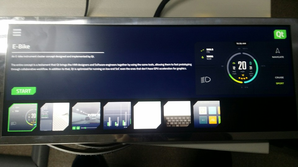

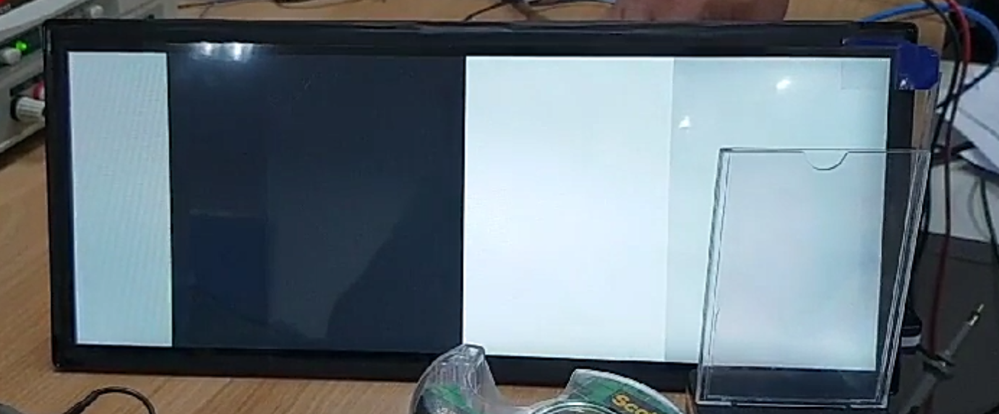

Hi all.
The display does not output normally.
1. This is the screen of the problem.
2. This is a screen that should come out normally.
Therefore, it is necessary to review whether the settings are correct in the bootloader and the kernel.

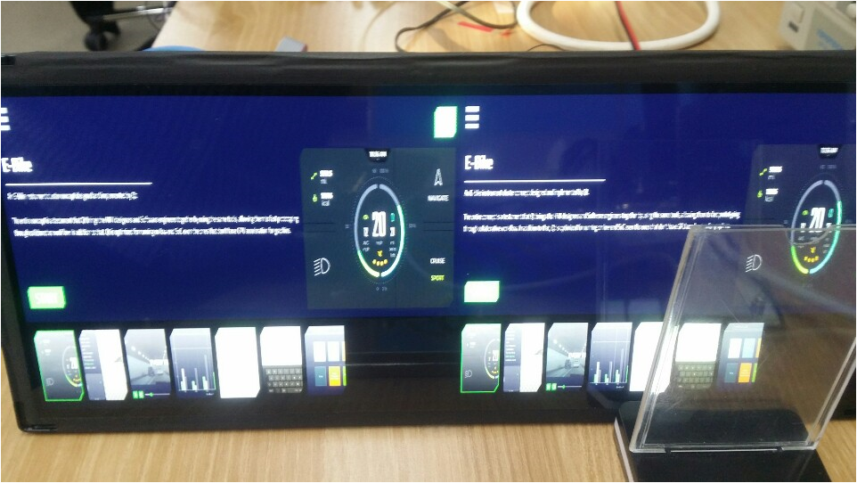

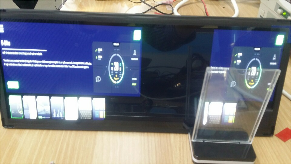

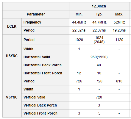

Hi.
There was a problem with the pinmap.
Now the screen comes out, but two screens are displayed instead of one screen.
1.set to split-mode
1) Timing
clock-frequency = <89400000>;
hactive = <1920>;
vactive = <720>;
hback-porch = <96>;
hfront-porch = <30>;
vback-porch = <3>;
vfront-porch = <3>;
hsync-len = <2>;
vsync-len = <2>;
=> Two screens, pushed to the right.
2) Timing
clock-frequency = <44700000>;
hactive = <1920>;
vactive = <720>;
hback-porch = <48>;
hfront-porch = <15>;
vback-porch = <3>;
vfront-porch = <3>;
hsync-len = <1>;
vsync-len = <2>;
3) If both of them operate in a single mode, the screen will not come out.
4) Data mapping was done with "spwg". (If you use "jeida", the colors are strange.)
I have to come out on one screen. Can you help me with setting up?
