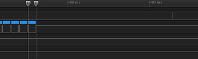

Hi All,
I am using MIMXRT1052xxx6B EVKB board and trying to capture idle line character.
I have enabled idle line interrupt in the code and trying to capture the idle line characters before IDLE flag set.
If i set 4 character in configuration,
pUart->CTRL |= pUartCfg->parity | LPUART_CTRL_IDLECFG(IDLE_FLAG_CHARACTER) | LPUART_CTRL_ILT(IDLE_FLAG_TYPE);
and toggling a pin in callback functions after generating interrupt and captured data on logic analyzer.
So i am getting more characters before IDLE flag set. ideally it should come 4 characters but getting more.
Is any one know why this is happening in case of Idle line interrupt for UART 3.
Please let me know if there any thing i am missing.

I recommend you to check our SDK example, we have several demos using LPUART and interrupts that you can use for reference.
