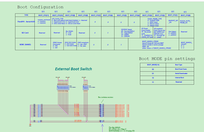

   Please also help to check the hardware, BOOT_CFG configure, do you select it as the QSPI, this is also important:
  Until now, your app image is correct, please also use your previously working Lauterbach download the .axf or the .bin, whehter that still can download the code, what's the result.

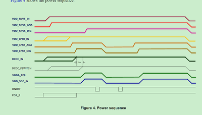

2. Then please refer to this document:
https://www.nxp.com/webapp/Download?colCode=MIMXRT1170HDUG&location=null
And datasheet power sequence
Do you match the power sequence?
3. check the boot_cfg, boot_mod pin configuration.
You must let the board find the ARM core at first, otherwise, you need to check your hardware, design, hardware solder, power sequence, etc. as it is totally not work.
