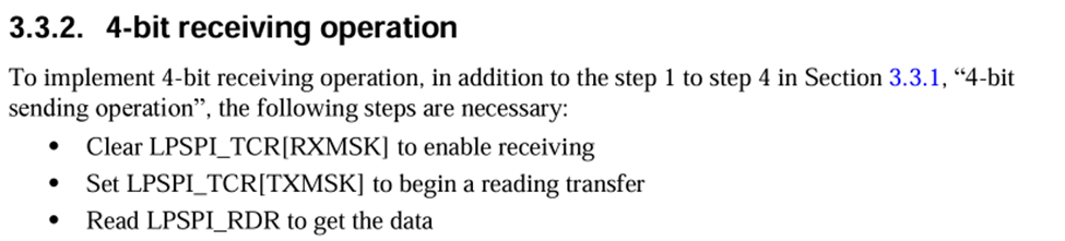

In the APP note it lists the configuration needed to enable the QSPI interface. Part of the configuration from the 4-bit sending operation section 3.3.1 is also needed for the Read operation (highlighted in yellow).

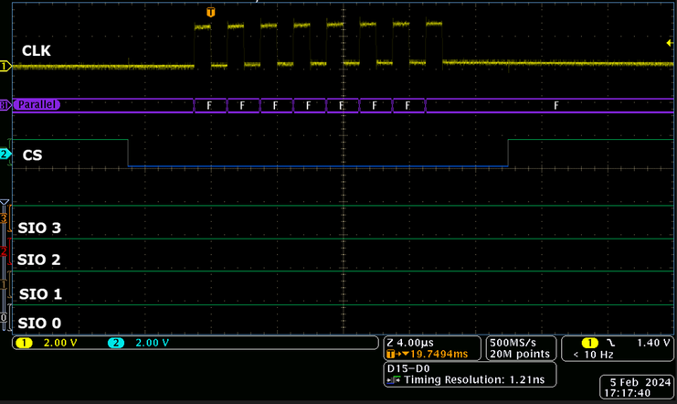

I’m probing the QSPI signals with an Oscope. I see 8 clock cycles per transaction, and 0xFF printed on the terminal, when it should be 0xFFFFFFFF. It’s as if the receive isn’t configured as QSPI, but instead as SPI.

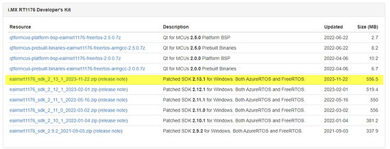

  • What SDK version are you using?
    • I started off with the LPSPI -> polling_b2b_transfter -> master -> cm7 example project
    • The SDK version that I am using was provided by embedded artist. It seems to be very similar to the NXP's SDK, but obviously has modifications to the code so it can run on the embedded artist RT1176 EVK
    • http://imx.embeddedartists.com/#imxrt1176
  • IDE version
    • Keil uVision 5 (V5.27.1.0)

I was able to successfully read 32 bits from the FPGA. The problem was that the default LPSPI project was configuring SDO in the wrong way. SDO was being told to retain its value. This was causing weird issue where sometimes I would properly decode the 32 bit word and other times I would not.  See highlighted.
