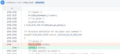

Issue:
802.11 IEEE station Power Save mode is not working as expected with the latest SDK 2.11.1, supporting NXP wireless solutions 88W8987/88W8977/IW416.
Solution:
Modify the structure in file : middleware/wifi/wifidriver/incl/mlan_fw.h,
Replace  “ENH_PS_MODES action” to “uint16_t action”.
 Note: This fix will officially be part of SDK: 2.12.0
