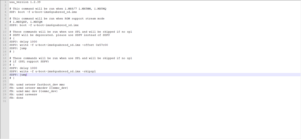

I think, I am using the same configuration in the UUU script. Below is my UUU script for loading the uboot.
uuu_version 1.5.21
# This command will be run when i.MX6/7 i.MX8MM, i.MX8MQ
SDP: boot -f u-boot-dtb.imx
# This command will be run when ROM support stream mode
# i.MX8QXP, i.MX8QM
SDPS: boot -f u-boot-dtb.imx
# These commands will be run when use SPL and will be skipped if no spl
# SDPU will be deprecated. please use SDPV instead of SDPU
SDPU: delay 1000
SDPU: write -f u-boot-dtb.imx -offset 0x57c00
SDPU: jump
# if (SPL support SDPV)
SDPV: delay 1000
SDPV: write -f u-boot-dtb.imx -skipspl
SDPV: jump
# use uboot burn bootloader to eMMC
# becaue difference chip, offset is difference
# you can use kernel to do that for specific boards
FB: ucmd setenv fastboot_dev mmc3
FB: ucmd setenv mmcdev ${emmc_dev}
FB: ucmd mmc dev ${emmc_dev}
I using the below uboot config
CONFIG_ENV_SUPPORT=y
CONFIG_SAVEENV=y
CONFIG_CMD_SAVEENV =y
CONFIG_ENV_OFFSET=0xE0000
# CONFIG_CMD_ERASEENV is not set
CONFIG_CMD_TFTPBOOT=y
# CONFIG_ENV_IS_NOWHERE is not set
CONFIG_ENV_IS_IN_MMC=y
CONFIG_SYS_MMC_ENV_DEV=2
CONFIG_SYS_MMC_ENV_PART=0
# CONFIG_SUPPORT_EMMC_BOOT is not set
But on flashing the board with UUU tools using above UUU script then its showing the below o/p.
flash target is MMC:3
But after flashing the board when Its reboot its changing the MMC and showing below o/p.
flash target is MMC:2
and on using the ">saveenv " command its giving
No block device
Failed (1)
Please have a look into this script and help me if any thing seems misconfigure in this.

rakesh3
Contributor V
Hi jackie, thanks for reply,
I am also using the same
uuu_version 1.5.21
# i.MX8QXP, i.MX8QM
SDPU: delay 1000
SDPU: jump
SDPV: delay 1000
SDPV: jump
FB: ucmd saveenv
FB: flash bootloader u-boot-dtb.imx
#FB: ucmd if env exists emmc_ack; then ; else setenv emmc_ack 0; fi;
#FB: ucmd setenv emmc_cmd mmc partconf ${emmc_dev} ${emmc_ack} 1 0
#FB: ucmd saveenv
FBK: DONE
But I am getting below error on using the saveenv command in UUU .
New USB Device Attached at 2:8
2:8>Start Cmd:SDP: boot -f u-boot-dtb.imx
100%2:8>Okay (1.399s)
New USB Device Attached at 1:9
1:9>Start Cmd:SDP: boot -f u-boot-dtb.imx
100%1:9>Okay (1.283s)
1:9>Start Cmd:FB: ucmd setenv fastboot_dev mmc3
1:9>Okay (0.001s)
1:9>Start Cmd:FB: ucmd setenv mmcdev ${emmc_dev}
1:9>Okay (0s)
1:9>Start Cmd:FB: ucmd saveenv
1:9>Fail Bulk(R):LIBUSB_ERROR_IO(0.148s)
1:9>Start Cmd:FB: flash bootloader u-boot-dtb.imx
0x400000001:9>Okay (0.18s)
1:9>Start Cmd:FB: ucmd if env exists emmc_ack; then ; else setenv emmc_ack 0; fi;
1:9>Okay (0.001s)
1:9>Start Cmd:FB: ucmd setenv emmc_cmd mmc partconf ${emmc_dev} ${emmc_ack} 1 0
1:9>Okay (0s)

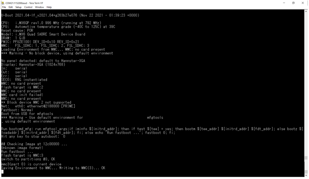

and on terminal , I am getting below.
U-Boot 2021.04-00007-g7ea82d90df-dirty (Feb 28 2023 - 18:09:37 +0530)
CPU: i.MX6D rev1.6 at 792MHz
CPU: Industrial temperature grade (-40C to 105C) at 36C
Reset cause: POR
Model: Freescale i.MX6 Quad SABRE Smart Device Board
DRAM: 1 GiB
PMIC: PFUZE100! DEV_ID=0x10 REV_ID=0x21
MMC: FSL_SDHC: 1, FSL_SDHC: 2, FSL_SDHC: 3
In: serial
Out: serial
Err: serial
Card did not respond to voltage select! : -110
MMC card init failed!
** Block device MMC 2 not supported
Net: FEC [PRIME]
Fastboot: Normal
Normal Boot
Hit any key to stop autoboot: 0
MX6 U-Boot >
MX6 U-Boot >
MX6U-Boot > saveenv
Saving Environment to MMC... Card did not respond to voltage select! : -110
No block device
Failed (1)
MX6 U-Boot >
I am getting "LIBUSB_ERROR_IO(0.148s)" error while using the saveenv cmd in UUU.
But on reboot its "falsh target is getting to MMC:2 " and then all issue starts.
Is this line correct ? Not mentioning the mmc dev in fastboot_dev any thing ?
