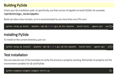

I have built the `img-image-full` image on imx8mp evk, and would like to install PySide6 on it.
This guide is telling me that the Qt installation path should be used:
Unfortunately, I couldn't find the `qtpaths` in my system:
Where is the qtpaths installed?

Hello emollegren,
Not sure about Qtpath since the path for QT is in the begginer of yocto with path, but this should be the path for installation: 5.15-0.0.1/sysroots/x86_64-pokysdk-linux/usr/bin/qt6/

Hi, there.
Thanks for your quick reply.
The problem is that the PySide6 installer needs `qtpaths` execution to resolve the paths of qt binaries.
How can we add the `qtpaths`?
