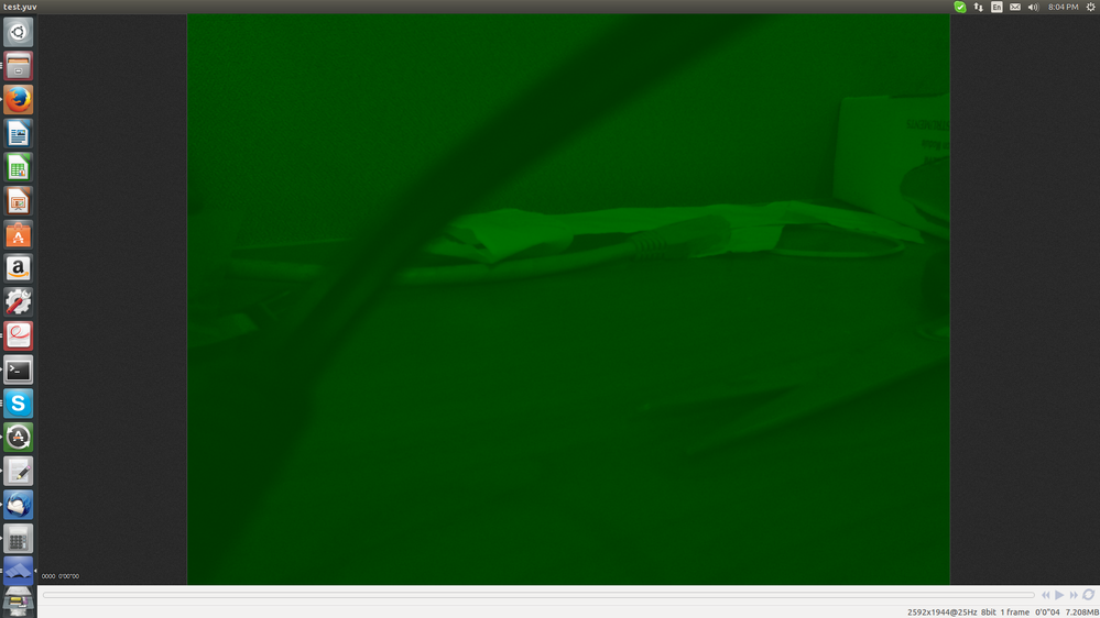

mohamedsarjoond
Dear Igor,
Thank you so much for the response.
I founf the reason for the issue. There is CSI MUX configuraion issue in board file.
I set the GPR13 register bits 0-2 as 0x4 since IPU1_CSI0 channel is connected to parallel interface.
And then the error went off and I can able to run the overlay/capture and even output application. But now the problem is the frames are having green lines fully.
 I referrred the file which you told to refer and ran your commands
capture: ./mxc_v4l2_capture.out -iw 2592 -ih 1944 -ow 2592 -oh 1944 -m 6 -i 1 -r 0 -fr 15 -d /dev/video0 -c 1 test.yuv -> ( video device is /dev/video0 for me)
overlay: ./mxc_v4l2_overlay.out -iw 2592 -ih 1944 -ow 480 -oh 272 -m 6 -fr 15 -di /dev/video0 -bg (lcd resolution is 480x272  for me)
output: ./mxc_v4l2_output.out -iw 2592 -ih 1944 -ow 480 -oh 272 -m 6 -r 0 -f UYVY -fr 15 test.yuv
All the above commands is giving same result... its coming with green lines. I have attached the captured raw file for sample
What is causing this issue. Any configuration settings is missing.
I have tried formats like YUYV, YVYU, YUV420 using -f command but all giving same results

igorpadykov
Hi Sarjoon
you are right green may be caused by wrong data format (or data absence)
so one can recheck if sensor was configured properly through i2c.
igor

mohamedsarjoond
Dea Igor,
Thanks for the response.
Do you have any application note for those i2c configurations.
We are using QSXGA camera as I said. Its 5MP camera with Auto focus feature.
Any configuration notes/details will be a lot of help.
