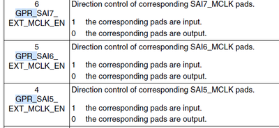

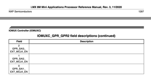

I debugged for a whole day, it turns out that we need to set bit GPR_SAI1_EXT_MCLK_EN of the IOMUXC_GPR_GPR2 register to 1. This register have no description in the reference manual (see screenshot below), but an excel file of iMX8MQ can be found online to describe this register. I hope that you can add a description to the reference manual to avoid confusion.

Hi @smartdev
Sorry for the confusion, the reference manual does miss some important descriptions. We shall work on the improvement.
Next time when you have similar unclear points, you may check on RM of other platforms, for example 8M nano:
I'm not saying this can always solve any problem, or excusing for the problem in the document. Just want to offer some methods for you to better process your project.
