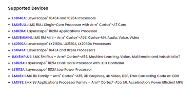

I am working L6.6.36 yocto bsp for imx8qxp
is there any rt linux  patch available for this board, if Yes what are the steps i have to follow in order to make it Fully Preemptible Kernel (RT)
S_katikala
938 Views
Manuel_Salas
Hello @S_katikala
I hope you are doing well.
NXP has a Real-Time Edge Software. Real-time edge software enables real-time capabilities via support for Preempt-RT Linux® for low latency applications, baremetal framework and support for real-time operating system (RTOS) on the Arm® Cortex®-A or Cortex®-M cores.
But unfortunately the i.MX8QXP is not supported for this OS.
Here are listed the supported devices:
There is listed the i.MXx Family, but it is only supported the i.MX8DXL.
