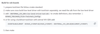

I am trying to build
https://github.com/nxp-imx/tim-vx-imx/tree/lf-6.6.23_2.0.0?tab=readme-ov-file
there is no .cmake file or prebuilt-sdk for nxp boards how do I build it?
for building on evaluation boards
where do I get the SDK
-DEXTERNAL_VIV_SDK

Hi @Zhiming_Liu ,
Thanks you, I see in yocto.cmake there are no include directories for VX
fatal error: VX/vx_khr_cnn.h: No such file or directory
29 | #include <VX/vx_khr_cnn.h>
compilation terminated.

Zhiming_Liu
The VIVANTE_SDK_DIR which is gpu source code folder and it is not open for customer, you can try YOCTO.cmake with exported Yocto SDK. The build will use gpu relate .so files from VIVANTE_SDK_DIR or buildroot/yocto sdk.
-DEXTERNAL_VIV_SDK =< yocto sdk sysroot>

Hi @Zhiming_Liu ,
where do I get these headers?
