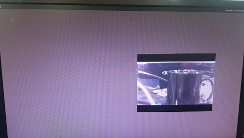

I have the MCIMX8M-EVKB.
The OS I use is L4.14.98_2.0.0.
I also have two USB Webcams.
My goal is to play several USB Webcams using USB3.0 of MCIMX8M-EVKB.
I connected the USB3.0 hub to the USB3.0 connector.
And I connected my USB Webcam to USB3.0 hub.
Since MCIMX8M-EVKB supports USB3.0, i expected that two webcams will be displayed.
However, when i play the second webcam, an error occurs.
debug console
root@imx8mqevk:~# lsusb -t
/: Bus 02.Port 1: Dev 1, Class=root_hub, Driver=xhci-hcd/1p, 5000M
|__ Port 1: Dev 5, If 0, Class=Hub, Driver=hub/4p, 5000M
|__ Port 4: Dev 6, If 0, Class=Hub, Driver=hub/4p, 5000M
|__ Port 4: Dev 7, If 0, Class=Hub, Driver=hub/4p, 5000M
/: Bus 01.Port 1: Dev 1, Class=root_hub, Driver=xhci-hcd/1p, 480M
|__ Port 1: Dev 10, If 0, Class=Hub, Driver=hub/4p, 480M
|__ Port 2: Dev 16, If 3, Class=Audio, Driver=snd-usb-audio, 480M
|__ Port 2: Dev 16, If 1, Class=Video, Driver=uvcvideo, 480M
|__ Port 2: Dev 16, If 2, Class=Audio, Driver=snd-usb-audio, 480M
|__ Port 2: Dev 16, If 0, Class=Video, Driver=uvcvideo, 480M
|__ Port 3: Dev 15, If 0, Class=Video, Driver=uvcvideo, 480M
|__ Port 3: Dev 15, If 1, Class=Video, Driver=uvcvideo, 480M
|__ Port 3: Dev 15, If 2, Class=Audio, Driver=snd-usb-audio, 480M
|__ Port 3: Dev 15, If 3, Class=Audio, Driver=snd-usb-audio, 480M
|__ Port 4: Dev 13, If 0, Class=Hub, Driver=hub/4p, 480M
|__ Port 4: Dev 14, If 0, Class=Hub, Driver=hub/4p, 480M
root@imx8mqevk:~#
root@imx8mqevk:~# ls /dev/video*
/dev/video0 /dev/video1 /dev/video2 /dev/video3
root@imx8mqevk:~#
root@imx8mqevk:~# gst-launch-1.0 v4l2src device=/dev/video2 ! waylandsink name=sink window-width=320 window-height=240 &
[1] 3986
Setting pipeline to PAUSED ...
Pipeline is live and does not need PREROLL ...
Setting pipeline to PLAYING ...
New clock: GstSystemClock
root@imx8mqevk:~#
root@imx8mqevk:~# gst-launch-1.0 v4l2src device=/dev/video3 ! waylandsink name=sink window-width=320 window-height=240
[ 40.968368] usb 1-1.3: Not enough bandwidth for new device state.
[ 40.975277] usb 1-1.3: Not enough bandwidth for altsetting 5
ERROR: from element /GstPipeline:pipeline0/GstV4l2Src:v4l2src0: Failed to allocate required memory.
Additional debug info:
../../../git/sys/v4l2/gstv4l2src.c(658): gst_v4l2src_decide_allocation (): /GstPipeline:pipeline0/GstV4l2Src:v4l2src0:
Buffer pool activation failed
Execution ended after 0:00:00.021582481
Setting pipeline to READY ...
Setting pipeline to NULL ...
Freeing pipeline ...
root@imx8mqevk:~#
root@imx8mqevk:~#

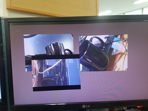

I expected the MCIMX8M-EVKB to play multiple webcams because it supports USB3.0.
How do I play multiple webcams using MCIMX8M-EVKB?
Below is my test.
I'm sorry I do not have enough English. :smileyhappy:
Thank you.

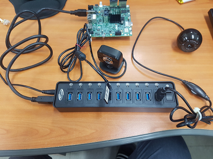

xoduddk123
Hi. CarlosCasillas‌,
I have tested with USB 2.0 camera and USB 3.0 Stroage.
The USB 3.0 device was recognized on Bus 02(5000M).
The USB 2.0 device was recognized on Bus 01(480M).

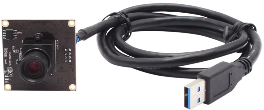

The USB 3.0 camera arrived and tested and shared the results.
I bought two USB 3.0 cameras.
https://www.aliexpress.com/item/32900431061.html?spm=a2g0s.9042311.0.0.5e294c4dORsvEH
USB 3.0 webcam x 2
The USB 3.0 camera was recognized on the 5000M bus.
Even if i try to play two USB 3.0 cameras, the same "Not enough bandwidth for new device state" error occurred and playback did not work.
USB 3.0 webcam x 2

USB 2.0 webcam + USB 3.0 webcam
Simultaneous playback of USB 2.0 webcam and USB 3.0 webcam was successful.
I tested the playback of a total of three cameras.
/dev/video0: MINISASTOCSI(MIPI-CSI Camera Module)
/dev/video2: USB 2.0 webcam
/dev/video3: USB 3.0 webcam

root@imx8mqevk:~# gst-launch-1.0 v4l2src device=/dev/video0 ! video/x-raw,width=1280,height=720 ! waylandsink name=sink window-width=640 window-height=480 &
[3] 4196
[ 3141.840638] ov5640_mipi 1-003c: s_stream: 1
[ 3142.037321] skip frame 1

Webcam output in MJPEG format
The USB 3.0 camera I purchased supports the MJPEG format.
So I tried to play it in MJPEG format as follows.
However, an error occurred and playback did not work.
How do I play webcam in MJPEG format on i.MX 8M?
I looked for community posts, but I could not find a way.
Or do you have to write a new article because the topic is slightly different?
