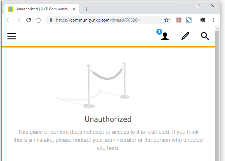

csoapy
Hi Irina,
   Both of two url are blocked, even if I've logged in.
