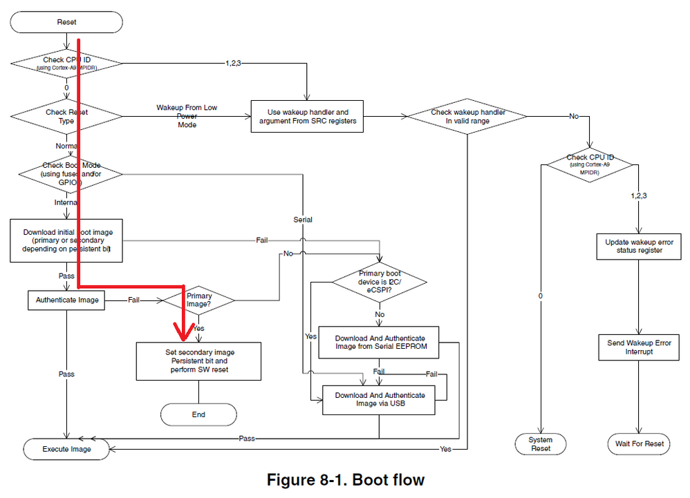

I have one question about usage of redundant boot and secondary boot image.
Following boot mode are supported redundant boot and it can boot from secondary image.
  • NAND boot
  • MMCSD/eSD/SDXC boot
  • SATA( HDD and SSD) boot (Sorry I missed. i.MX6 Solo/Dual Lite not support SATA I/F)
And others not support redundant boot
  • Parallel NOR Flash
  • One NAND
  • EEPROMa boot (SPI, I2C)
Is it correct?

I hope to know when is secondary image used by boot ROM.
I think it has 4 pattern
  1. ECC error in raw NAND boot.
  2. Load image error? in redundant boot(MMC/eMMC/SD/eSD)
  3. Authenticate Image is fail in Figure 8-1 of Reference Manual IMS6SDLRM rev4.
  4. SATA boot for i.MX6DQ
In case 3, If it is correct, it seems that all internal boot mode will be used secondary image if authenticate is failed.
Which boot mode does it support to use secondary image in this case?
If other case it is used secondary image, please let me know.
Ishii.

Yuri
Hello, Ishii !
  The secondary image is used in the Closed mode, if  Authenticate failed.
No more scenarios for the redundant mode.
    For the Closed mode, if there are failures during primary image authentication, the boot
ROM turns on the PERSIST_SECONDARY_BOOT bit (see Table 8-6) and performs the
software reset. (After the software reset, the secondary image is used.)
Yuri.

Hello Yuri,
Thank you for your answer.
I understand that the secondary image is used in the closed mode only.
If I use Parallel NOR-Flash boot with closed mode, where is a location of Secondary Image Table?
Boot Rom will read table from address 0x200 is correct?
IVT offset is different both NOR and OneNAND in table 8-23.
But I can't find location of secondary image table for NOR flash boot
both Reference Manual and Security Reference Manual.
Ishii.

takayuki_ishii
Contributor V
Hello Yuri,
I confused now.
Boot ROM are set secondary image persistent bit only following 2 condition.
  1. Redundant boot=Yes, Closed mode=Yes, Primary boot image authentication is fail.
  2. In NAND boot, ECC can't correct during the primary image read.
So, the secondary image may only be referenced during a NAND boot or
redundant boot (it support for MMC/eMMC/SD).
Other boot mode(Parallel NOR, OneNAND, EEPROM) have no time to referenced secondary imae.
Is it correct?
Ishii.

takayuki_ishii
Contributor V
Hello Yuri,
Thank you for your quick response.
I was able to understand how work boot ROM and secondary image.
