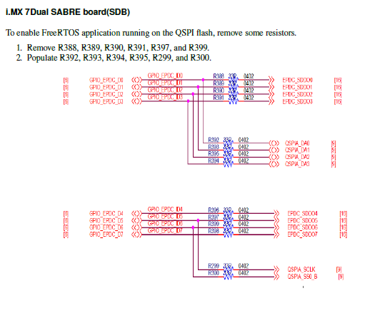

I am using "FreeRTOS_BSP_1.0.1_iMX7D_1.1_ER_Win" and following section 6.3 to run hello_world_qspi.bin
Built fsl-image-gui-imx7dsabresd.sdcard image by adding below line in to conf/local.conf [to enable qspi1 in U-Boot]
UBOOT_CONFIG = "qspi1"
ERROR while loading SPI flash
=> fatload mmc 0:1 0x80000000 hello_world_qspi.bin
reading hello_world_qspi.bin
10604 bytes read in 33 ms (313.5 KiB/s)
=> sf probe 0:0
SF: Unsupported flash IDs: manuf ff, jedec ffff, ext_jedec ffff
Failed to initialize SPI flash at 0:0
Could any one please help me . what i am missing ?

I got it working guys ..
as i said if your using kernel 4.1.12  ,we dont have to do any changes.
The problem is i was missing some hardware setting .
After hardware setting according to below . it started working fine
Thank a lot for replay guys

tian
the qspi flash resistor must be populated. Now it was not
