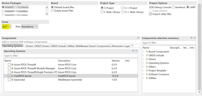

Unfortunately, there is not a document on how to create a C++ FreeRTOS project nor SDK's examples. Nonetheless, if you are using MCUXpresso IDE for your project, you could create a C++ new project with FreeRTOS as Operating System, and then import your .mex file (ConfigTools file).
[MCUXpresso IDE -> Create a new C/C++ project… -> Configure the project]

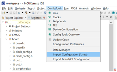

[MCUXpresso IDE -> Import Configuration (*.mex)]
Next, you might have to open the ConfigTools from MCUXpresso IDE to deal with the warnings and errors doing right click on those you have a lightbulb next to it, after fixing all of them click on Update Code, and go back to the Develop Window to continue with the project.
