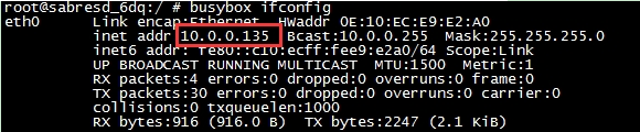

Hello
My environment is i.MX6Q sabreSD ,AR8031 phy,and OS is android 4.4.2.We use local network and we don't use wifi.We use RJ45 to connect a router.
When power on ,we give a static IP address to our board,.
but after several times of pluging/unpluging RJ45,the static IP address is changed to another.
Then we continue to plug/unplug sereral times,the IP address lost.
And I got this log from Android.

lqll
Hi igor
Thanks for your reply.

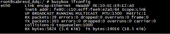

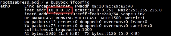

My problem is no relation to uboot.No matter what IP address setted in uboot,I will change IP address in kernel, and this is my command:
ifconfig eth0 10.0.0.135 netmask 255.255.255.0
But after I plug and unplug RJ45 many times,My static IP address auto change to 10.0.0.32,then I continue to plug and unplug RJ45 many times,the IP address is gone.
During this test,I didn't reboot board or reset IP address,and didn't run any APP.
