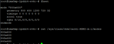

I have some problem about HDMI resolution. Anyone can give a suggestion about this? Thanks in advance!
I tried to setup bootargs as below Monitor-not-working :
After boot completed, I tried some commands but it showed 800x600 in HDMI resolution.
Imx8mp settings:
MACHINE=imx8mp-lpddr4-evk
DISTRO=fsl-imx-xwayland
OS: imx-linux-kirkstone imx-5.15.71-2.2.0.xml
2,420 Views
Bio_TICFSL
The EDID of the monitor is being received and stored in /sys/class/drm/card0-HDMI-A-1/edid (attached).  Here are the supported modes of the monitor per the received EDID:

KenBCHu
Hi @Bio_TICFSL,
I would like to set HDMI resolution to 1280*720.
Currently, I get nothing at /sys/class/drm/card1-HDMI-A-1/edid.
I checked the url you shared, and it seems to set more pixel clock in platform.
Is it necessary for IMX8mp platform? The code in the link is quite different from my current version. Is there an example about setting resolution to 1280x720?
